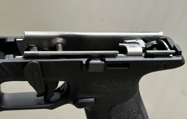

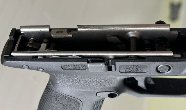

For comparison, here’s a bent metal framed modular FCU from one of my Beretta APX A1 Compacts:
The slide has a slight amount of vertical and horizontal play.
Also, manually pressing the sear down raises the lever that pushes against the striker safety block. They are two sperate parts, but they interface with each other such that they move together.
