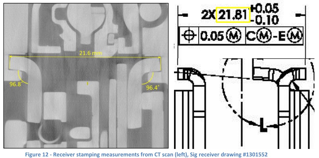

Originally posted by Rusty_SWO:
Originally posted by rscalzo:
As far as your "more expensive manufacturing techniques" care to tell us what you'd improve based on your knowledge of their current techniques? I'm guessing that you must be familiar with their current manufacturing based on personal knowledge? Is the fact that they use modern high end machinery not suitable?
I’m an engineer working in manufacturing. My background is in machinery design, and I’ve done quite a lot of molded parts, bent sheet metal parts, and machined parts.
I have *never* specified tolerances of +.002”/-.004” on a bent sheet metal part.
Why?
Because I know there’s NFW I’m going to actually achieve them.
And guess what? Sig didn’t achieve them either.
Incidentally, the frame rails being shaped like that (in other words, both undersized and not even close to square) could quite easily account for a lot of the so-called “shake-awake” behavior.
Mine measures exactly the same, by the way.

I’ve gathered data points from 11 guns so far including my own X5 Legion. 2 of them have been close to the bottom end of the spec but still within tolerance. The remaining 9 were all out of spec, with one high(somehow?) and the rest clustered right around 21.6mm.
