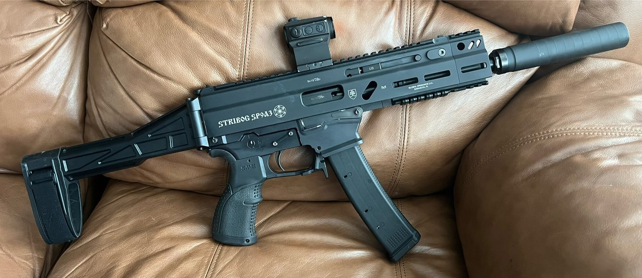

I think I just didn’t give it enough heat. Wound up boiling it for twenty minutes and it came loose with ease. I have four bolts on the Scorpion I forgot I used Rocksett on ( Roll Eyes) that I need to remove to get the barrel off, so I’m about to try my way again a bit later tonight.
Tri lug is a trip. Doesn’t seem as solid as the other methods I’ve got experience with, but as long as it holds it concentric to the bore and doesn’t launch it down range, good enough is good enough. Looking forward to getting the SP9A3 to the range. A friend of mine is putting together a range trip for the 15th, so that should give me enough time to hopefully get the Scorpion barrel to my buddy’s machine shop, get it turned down and get the other tri lug on it, and then I can do a direct comparison between the two suppressed.

Yeah, I think it ought to work out fine. I’ve been attaching and removing a fair bit over the last few hours because of the sheer novelty of it all, and I’m both amused and impressed. Big Grin
There is far too much barrel and suppressor sticking off the end of this for my liking, and now I’m wondering if a handguard extension is the way to go, or have my machinist friend chop the barrel and thread it to be flush with the receiver. Need to shoot it before I start deciding things.

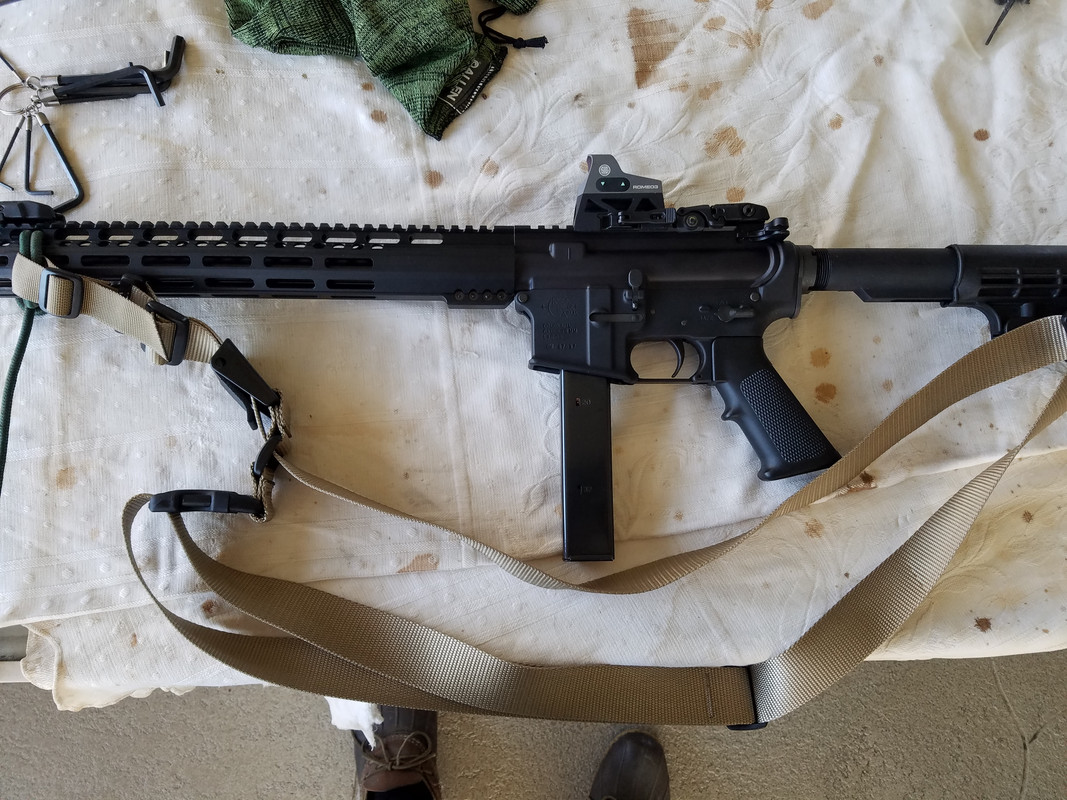

I love this one. It's an RRA with a Colt block installed, and takes 32 round Colt stick magazines.
As shown, it has a 16 inch barrel, since the lower left the factory as a rifle. This makes it very accurate at 50 yards and also ensures low noise and virtually no recoil. With a 10.5 upper, it would be perfect, but I would have to do that on a separate pistol build with a different lower.
Honestly, though. This is a fantastic home defense firearm. Accurate, hard hitting, low noise, zero flash, light, and agile.

Well, I got the Scorpion apart and dropped the barrel and tri lug with my machinist friend. He said he'd have it back to me by the middle of next week. Gives me time to put it back together for a night shoot I'm planning for that weekend. I'll get to compare the Scorpion and the SP9A3 suppressed with subs on a silent range. Looking forward to that. I'll have a friend take video and see if we can't compare the amount of port pop/flash between the two. Got a case of 147gr subsonic coming, so I should be set for a little bit with that plus the half case or so I still have on hand.
I picked up a JTAC extension for half the price new, from a guy who bought the wrong one. It evens up the receiver extension about flush with the shoulder on the barrel, so all that's sticking out is the tri lug. I also gain another MLOK slot and three more Picatinny slots on top and bottom, plus a QD pocket on each side. I was concerned it might feel a bit janky, but it is super solid. Also installed the HBI locking charging block and extended bolt catch/release. Big improvement in feel, overall.
Got my Form 1 draft totally filled out and ready to file. Money thinned out a bit in the last week, so I won't get to file it as soon as I'd hoped, but when I do, I have the B&T MP5 stock ready to go. I'm looking forward to finishing this one up. I think the only thing it actually still needs is a decent trigger. Anyone ever shaved down the hook off the back of a USGI hammer? I don't need it to catch an auto sear and I think it would drastically improve the lock time. The trigger feels kind of like a flintlock. Razz
Oh, and I sent Global Ordnance an email asking about the 40 degree locking insert and got an email back this morning asking to confirm my shipping address and phone number so they could send it out. After reading up, a lot of guys report that it's the last little bit missing between where it is stock, and MP5-smooth when suppressed and shooting subs. It's designed for the heavier loads and handles it better than the 45 degree "US" locking insert it has shipped with since 2022, which was meant to deal with 115gr powder puff stuff, which I mostly won't be shooting anyway. The recoil impulse is apparently also less of a shuffling feel than an MP5. A friend of mine has a nice clone built up, I'm gonna see if he'll bring it to the night shoot so we can compare.

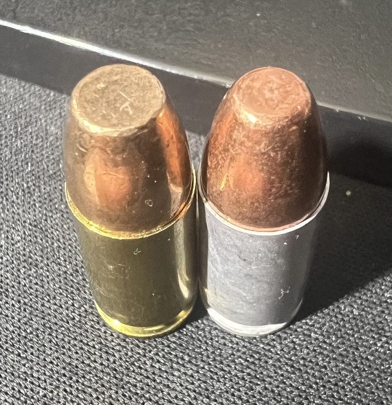

Well, I made an important discovery. Some (or even most) Stribogs don't like to feed some flat point ammo, and many hollow points. This is a known issue in the community, and mine is apparently one of them. Over the last several range trips, I've run into some serious problems. I shot a match last month and out of thirty rounds on the first stage, I think I managed to get two to feed in a row, otherwise it stovepiped every round. I think the par time was something around 40 seconds and I was over four minutes on it. In the daylight, it would've been faster and easier to clear, but on a moonless night under NODs, I had to do it all by feel. I thought it was the magazines because they were the original OEM CZ Scorpion magazines from 2015, but then I started having problems with my Pmags as well. I started marking mags that gave me trouble with painters tape and when it was more of them than not, I decided I needed to do some troubleshooting. Yesterday over several hours at the range, I isolated it down to the Federal American Eagle AE9FP. Every combination of magazine and locking insert worked with every other combination of round nose bullet I brought, but any combination of the above involving the AE9FP had failures to feed. I could not induce a failure that didn't involve that ammo.
I didn't have these failures with CCI Blazer flat nose, I didn't have these failures with the Aguila flat nose, both in 147gr. It's just been the American Eagle. I've shot up all the CCI, but I think I may still have some of the Aguila loaded up, and if so, I'm going to take a caliper to ten of them and get an average OAL and compare that to the AE9FP and see if there's enough of a difference there that's possibly contributing. Whatever it is, I'm not going to bother trying any more of the AE in this gun. I'm also going to look into polishing the feed ramp, because that probably can't hurt. Interestingly enough, it liked 147gr HST's, and they remained subsonic as well. I think if I can get another 500 rounds through it without a problem, I'll call it fine for a defensive option.
Worth passing along to anyone else reading this, I think. I'm shooting an NVG match tomorrow night, and I'm going to load up some Pmags with some round nose 147gr PMC Bronze that it likes and see how it does. Later tonight, I'm going to detail strip it and throw it in the ultrasonic, because it's absolutely caked in filth. I wish I had kept close track, but I'm easily north of 2k, probably close to 3k rounds through it. I shot at least another 600 in the last two weeks. Quite pleased with how it shoots, and after swapping out the locking insert and back again, I can confirm that the original 45 degree non-"US" marked locking insert has noticeably less recoil suppressed, which has less noticeably less recoil than shooting it without a can in the first place. It's doing exactly what I was looking for: a quiet, smooth-shooting "subgun" that feeds from the ubiquitous Scorpion magazine.

You’d think issues with feeding like that would have been noticeable during design and testing phases at the manufacturer.
Yeah, you'd think so. Apparently, the gun was designed around hotter European and NATO spec 9mm. Concessions and iterative changes have been made to work around the varieties of 9mm we like and use in the US. They changed the export version to use a 40 degree locking block instead of the original 45 degree, for example. These are marked "US" on the left side. This makes for more vigorous cycling with all loads, and is more reliable with powder puff 115gr stuff. Since I pretty much shoot it exclusively suppressed and with heavier subsonic ammo, I asked the importer if they had any 45 degree locking blocks kicking around, and they sent me one for free. It is noticeably smoother recoiling in my setup.
I shot another match last night, and this time, I brought Pmags loaded only with PMC Bronze 147gr round nose. It ran flawlessly, and was easily the quietest setup of anyone in our squad, and there were several other suppressed 9mm PCC's. One stage had three steel targets at 50 yards that had to be engaged with one round each from three different positions for a total of nine rounds. A buddy got a video of my run, and you can hear a sidebar conversation of a guy exclaiming "Jesus!" three shots in a row, followed by another guy telling him "yeah, suppressed PCC's, man." Big Grin
I never did get to clean it before the match, but that's the plan for later this evening. Everything is going in a fresh, heated bath of Simple Green Aircraft grade in the ultrasonic, and then reassembled and greased. I need to pick up some Mother's Mag and a rouge cloth and see what I can do with the feed ramp working it manually.

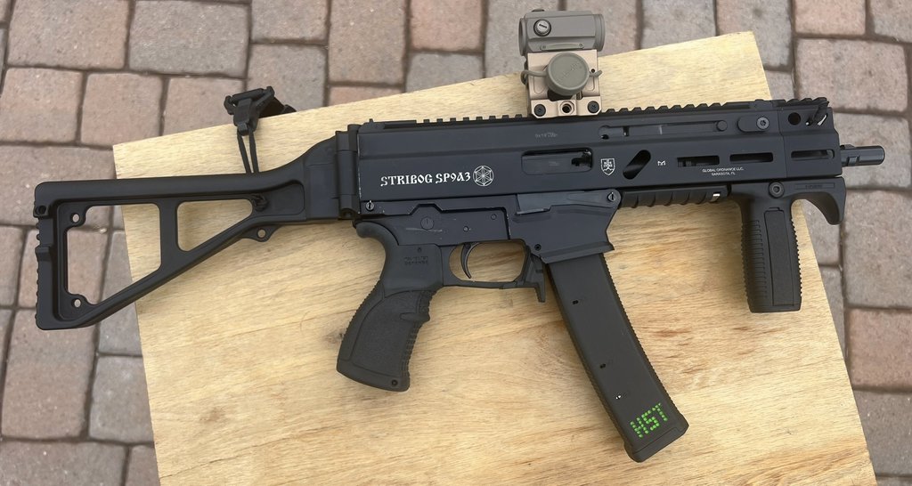

I purchased the Stribog SP9A3 9mm sometime in 2023.
I had feeding issues with factory curved 30rd & 20rd straight mags. FTFs, FTEs, stovepipes. You name it, I probably experienced it. Left that day frustrated.
Went home & did more research. I've read that there's a break-in period of 500rds, but I didn't want to waste 400 more rounds if there was a known issue.
I contacted Global Ordnance who imports the Grand Power and received a prepaid shipping label to send it back. The armorer returned it a few weeks later with a note that said he correctly reassembled the buffer assembly & test fired it with zero issues. No further notes after that.
It sat in the safe for a few months before I finally got to it. Before then, I purchased some new US made gen 2 Stribog mags that Global Ordnance released to give those a go. Apparently, "features an enhanced feed angle, ensuring reliable feeding of hollow points, flat nose rounds, and all other types of 9mm ammunition."
I took the Stribog to the range last Saturday & loaded up the new mags with 200rds 124gr & a box of 50rds 147gr HST. It ran flawlessly. I was thrilled & happy there weren't any issues so far. Unfortunately, I didn't bring any of the older mags to test. I will bring those on the next range trip.
After reading your issues with the AE 147gr flat nose, I have the same rounds & will give those a go as well. Fingers crossed
