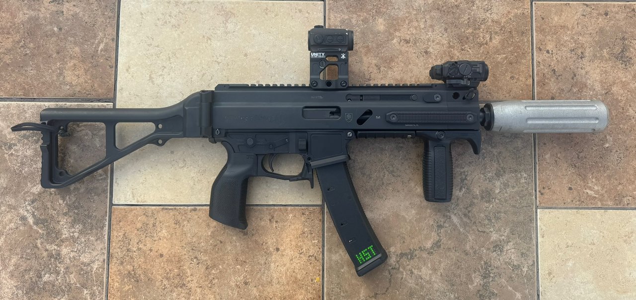

You know what? It's been a bit since I did a picture. A few things have evolved since the last one.
Stealth Additive Works 9mm Tisha has replaced the prototype can of theirs I got last year. I haven't shot this exact one yet because I picked it up yesterday, but the one I shot on this setup a few months ago was notably quieter. Like, shockingly so. I didn't want to want one because I thought it was so damn ugly, but here we are, and it's growing on me. Someone asked them to make a suppressor that looked like the old Delta Tek flash hiders, so they did, and honestly... I think it kind of looks at home on an angular, blocky Euro gun. Razz
It's more compact with the Tisha, very slightly more muzzle heavy (2oz heavier than the old can), and yet feels more correct, somehow.
My machinist friend is up to his eyeballs on a huge contract and told me he couldn't spare any pro-bono shop time until about late September, so... I'm just going to do my best with my drill press and if I hog it out real bad, well... I know a machinist. Big Grin
I started to type up about everything involved in the steps I'm going to take in experimenting with getting it to run with an FRT, but I think that's best saved until I have it working right. It involves various materials for both the slip trip and the buffer, so... money where the mouth is and all that. I want it showering brass reliably before the last week of October because if so, it'll make a fun demo gun for the SAW booth at the EVT range day this fall. And then I can just tell you guys what I did to make it worth and you can do the same if you want. Easy. Smile
