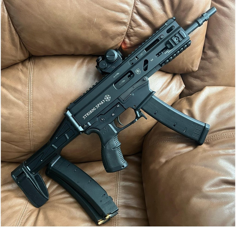

Got it home. First impression is this is a really well-made firearm. Machining is clean, everything fits together nicely, no rattle - snug, and smooth.
HBI’s B&T MP5 stock retrofit kit is probably going to be the way to go. I like the way it looks, I like the length of pull, and the hinge mechanism will accept the SBT Bren 2 brace I have sitting on a parts shelf. That can hold me over until I’m ready to paper it I guess.
The hammer my binary uses won’t fall correctly when mated to the upper. Going to need to see if the other, smaller style will work with the whole system. If not, I’m gonna need one of those anyways to go in the lower and yank all the binary stuff out and go with a decent AR trigger. I have a spare ALG QMS in a bag of parts somewhere that’ll work for now. Would be nice to have a binary in it, but it’s looking like a lot of hoops to jump through to make this particular one work. We’ll see.

Well, I had used some snap ring pliers to get the Silencerco direct thread mount into my can in the first place, just hand tight. Yeah... I know. Big Grin
It doesn't wanna get it backed out because it's not the right tool. Mount has no wrench flats, which... is wonderful. Ordered a variable pin size spanner wrench, should be here in the morning. I'll get it wrapped up in a scrap bike inner tube in the vise and see if it'll come out easy. I think if it had wrench flats on the base, it'd already be a done deal.
On that note, the Kaw Valley Precision stuff showed up. I'm suitably impressed. The tri lug is mounted on the Stribog and the tri lug mount goes on smooth with zero play, locks up the way it ought to. Can't wait to get it mounted in my can. Taking my Scorpion barrel to my buddy's machine shop tomorrow, hopefully that doesn't take long. It'll essentially have the tip of the tri lug flush mounted with the 6" handguard when he's done, so the can will be a little recessed. An improvement, to be sure.
Handling the Stribog with the brace and red dot mounted, it's striking how much slimmer, lighter, and handier it feels compared to the Scorpion. I have to drive to NY and back starting next week, so it'll be a little bit before I can really try it out, but when I do, I'll get to shoot it suppressed and compare it to the Scorpion pretty much straight away. I'm gonna yank the binary out of the Lingle lower and just see if it'll take the ALG trigger I have sitting around. If it'll function check with that, I'll be a happy camper.
