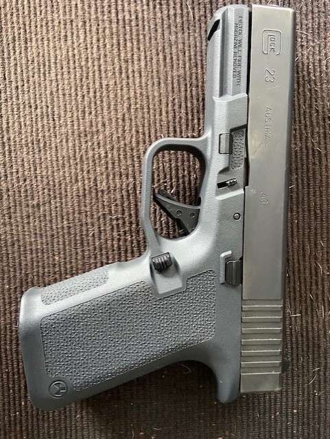

has anybody stuck a G23 or G32 slide on it yet and tried for 40 or 357 sig ?
Will have a first-hand knowledge of this for you in about 5 days.
Posts: 946 | Location: FL | Registered: January 29, 2001Reply With QuoteReport This Post
The trigger mechanism housing, and specifically, the ejector, will be the problem. Glock and Ruger trigger mechanism housings are not interchangeable, but if the Ruger TMH is like the Glock TMH, the ejector is replaceable. At a minimum, you will need the .40 ejector, which means buying a Glock .40/357 TMH, because I don't think Glock sells just the ejector.
Thank you. I won an auction for a complete Gen 3 G23 upper and all the lower parts, so I should be getting the ejector. I bought the RXM last week. Haven't shot it, yet, but love everything about it, so far.
You'll have to pull the ejector out of the TMH with a pair of pliers- ideally, in such a way as to not bend or mar the nose of the ejector.

Hand fed and ejected fine. Haven't changed the ejector or fired, yet.

Once you have the .40 ejector installed, you should check with Ruger to see if they will be selling the trigger mechanism housing as a separate part, and that way, you can switch between 9mm and .40 simply by switching the TMH.
.40 ejector and Hackathorn sights have been installed. To change the ejector, all it took was a set of pliers and I didn't have to remove the assembly from the grip. As far as a separate trigger mechanism housing, I want to see how the 9mm casings eject with the .40 ejector. Online research yielded that about the only problem would likely just be erratic ejection, which I can live with.
It may work to leave the .40 ejector for 9mm as well.
What you don't want to do is remove and replace the ejector repeatedly, because the TMH/ejector assembly is intended to be a single assembly, and switching out the ejector would result in wear of the polymer socket in the TMH.

Yes. The plan is to just use the .40 ejector if 9mm functions with it. If it doesn't, then I'll be contacting Ruger to try to get a second TMH. I hope to get to the range this weekend.
