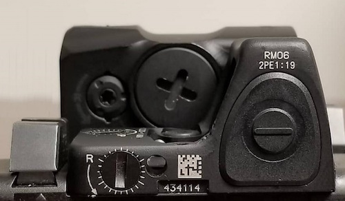

I only have the RMR.
As far as printing, I carry appendix at around 1'oclock, and have no issues with the grip printing. For me, the part that would print the most up front is the top corner of the slide, so having something like an ACRO would amplify that area big time.
The hood of the RMR is right above the belt line, so it is hidden.

I have some concerns, perhaps in ignorance, about debris build up blocking the RMR emitter. Generally the holster is against bare skin. I get considerable build up of lint, dust, dander, etc. Doesn't affect function. But may block the emitter.
Practical concern? Functional concerns here would outweigh printing concerns.
Most of my dust build up is behind the glass window.
I give the front and back of the window a quick wipe with a microfiber every night. I keep a q-tip in my desk drawer and give the emitter a quick wipe also.
Never felt like I have to do it for it to function, but it only takes 5 seconds of my time.
