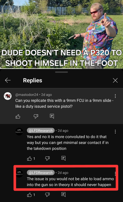

It was amateur gun hack and Youtuber "Hawaiian Shirt Guy" (calls himself "LFD Research") that started the whole ....storm about swapping safety levers and omitting the striker block.
Then he posts this
Sometimes the Internet is a wonderful thing and sometimes it's not.
