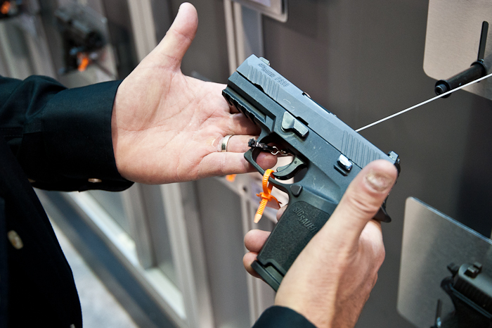

The P320's introduction at Shot Show in 2014 indicated trigger safeties were going to be available as an option. But once it was fully rolled out onto the market, it seems that had been dropped. (And Sig specifically used the lack of a trigger safety as a selling point initially.)
Visible here at SHOT:
Also a "tabbed safety trigger" listed as an optional safety on the left and shown on the right, in this early info sheet:
And see ~0:57 here, where a Sig rep at Range Day specifically states that it is an option aimed at those law enforcement agencies that want it: https://www.youtube.com/watch?v=DM1cf5cb2P0
Plus ~1:00 and ~2:06 in the early P320 announcement/introduction video here, where Sig talks about "interchangeable trigger options" for tabbed or not, and how it's "available but not required for the P320 to be safe": https://www.youtube.com/watch?v=6hC_GOBfoiU
