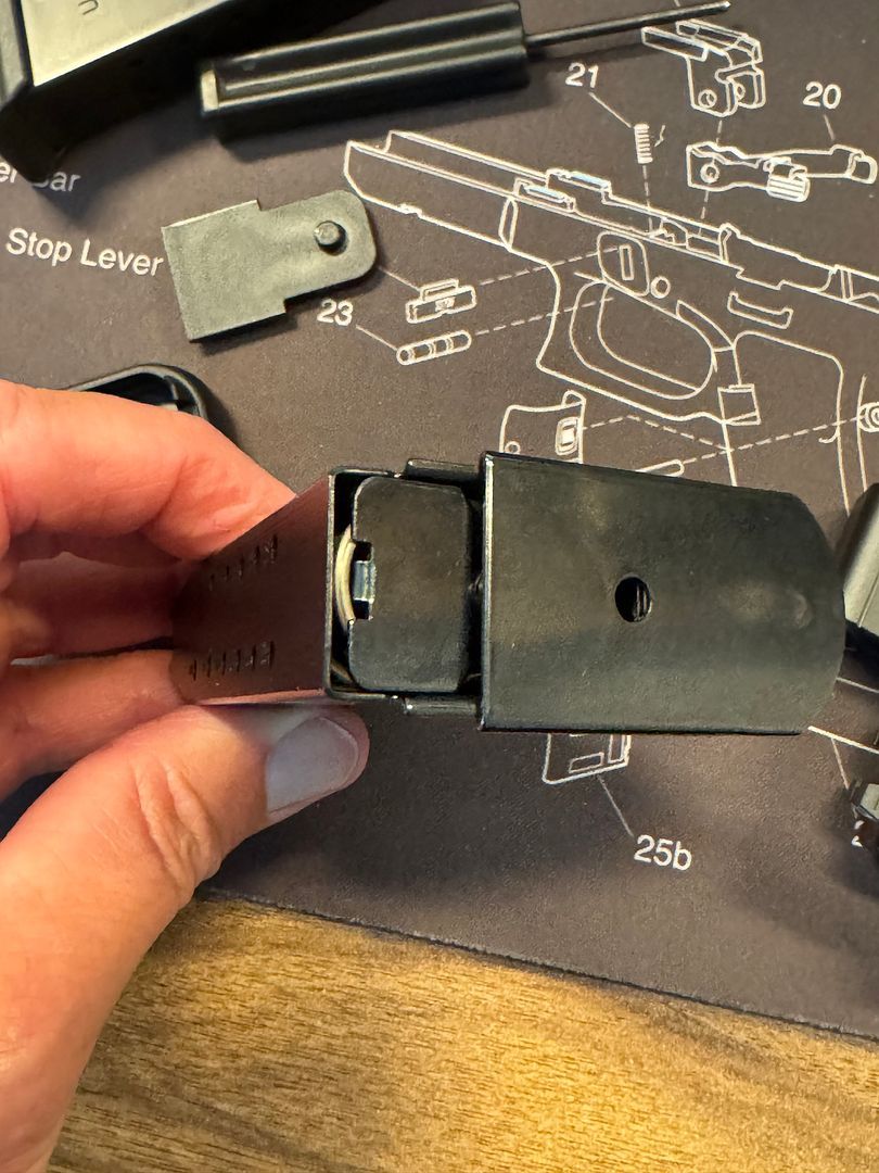

Originally posted by 1lowlife:
Have you gotten a response yet?
I'm having the same issue with three 15 round mags. Stock 10 rounders and Daggers drop free no problem.
Yes, I emailed the address provided on Glock contact us explaining my issues, and they responded the next day.
They sent me a warranty form that I filled out and printed.
Then I sent the mag to them USPS and they will issue a replacement once they receive it.
So far, pretty damn good customer service...
Glad to hear. These are worthless if they won't drop free. I emailed them yesterday and got a response from them earlier today asking for more info.
Similar to what Pete said above, mine appear to be dragging around the mag catch notch. They measured 0.030 wider then both my factory 10 rounders and the Daggers in that area.
I did describe in detail with the pics I posted here.
I tend to overexplain everything just like I'm doing right now. Eek
I also told them I felt it was the mag body because I swapped the spring and follower with one that dropped and had the same issue with the same mag body.

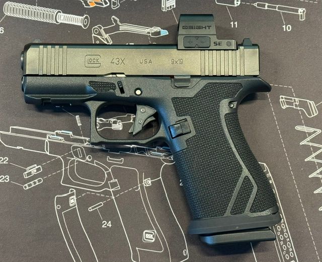

I picked up a Radian Ramjet for my 43X. I know, I know! AFTERMARKET PARTS. Whatever. I'm going shooting with the boys in a few hours, gonna try it out vs the stock barrel. With any luck, it'll soften up the felt recoil enough to not give me sharp, stabbing pains in my elbow with every shot. Frown

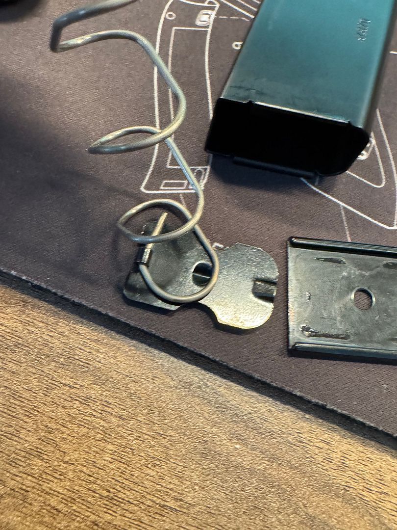

I wonder if the flat steel P226 magazine base plates would fit. Mecgar has a rubber covered flat base plate and retention plate set in their lineup. I always assumed that the 15 round mag body was oversized.

I received my 43X mag back from Glock last week.
I think they just replaced part(s) on my original mag.
They shipped it back in the same ziplock snack bag I sent it in.
Seems to drop free now.
It was just over a 3-week turnaround.
Not bad.

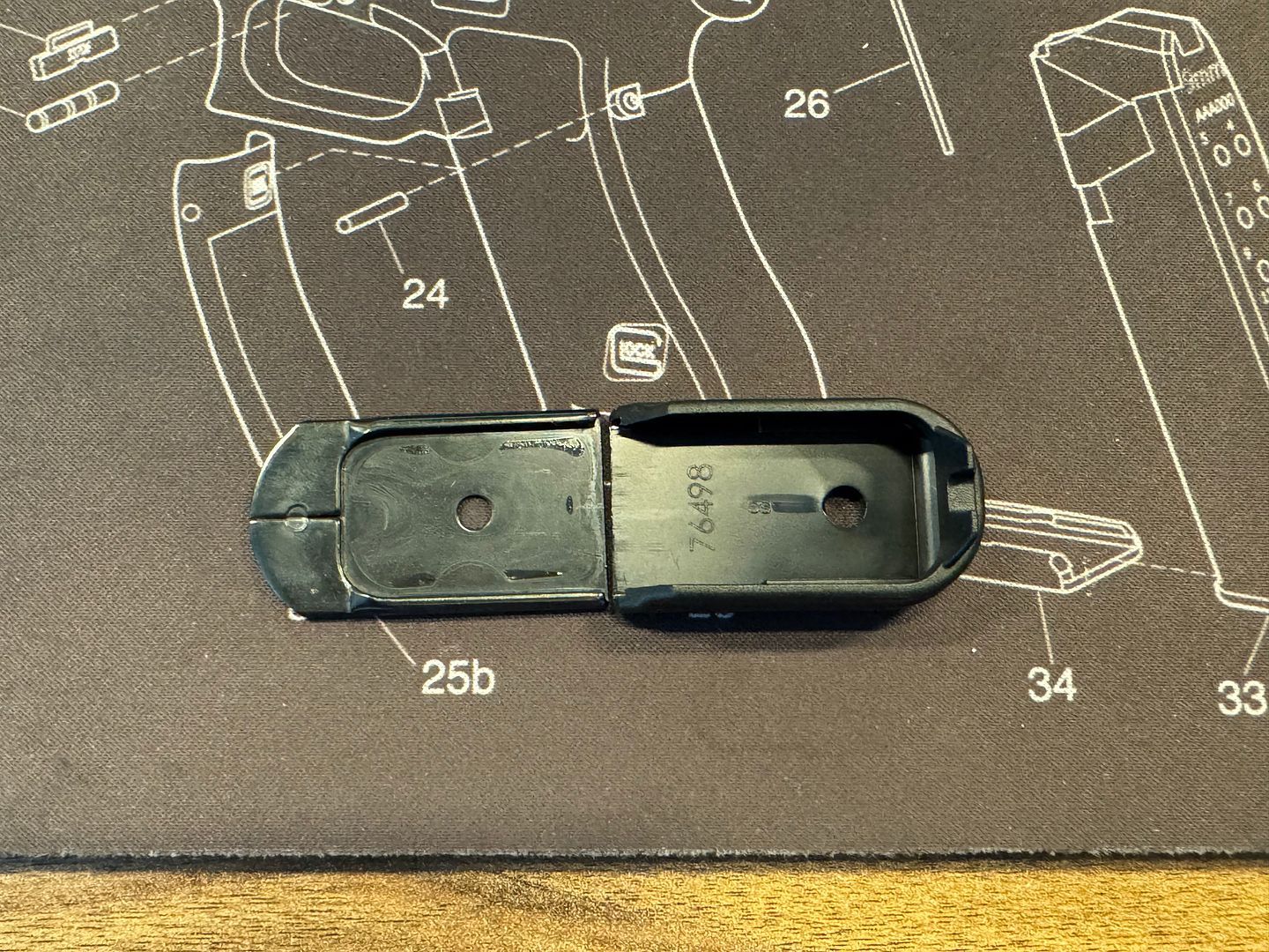

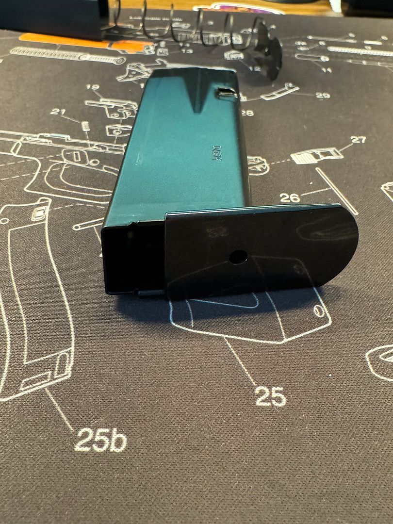

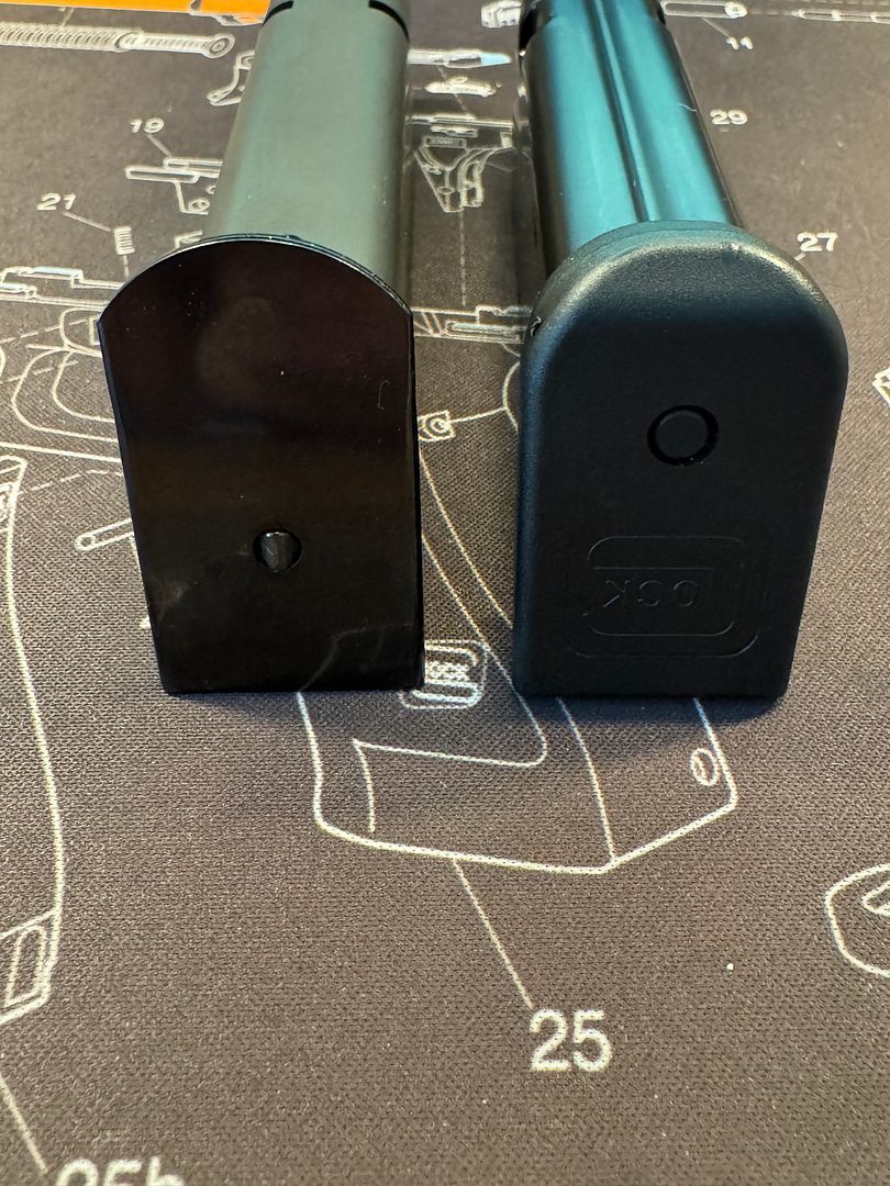

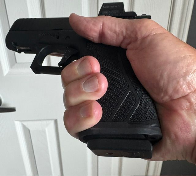

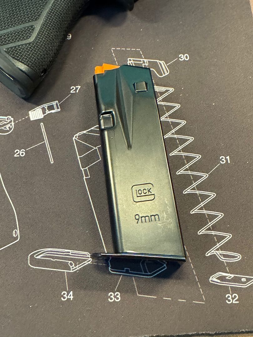

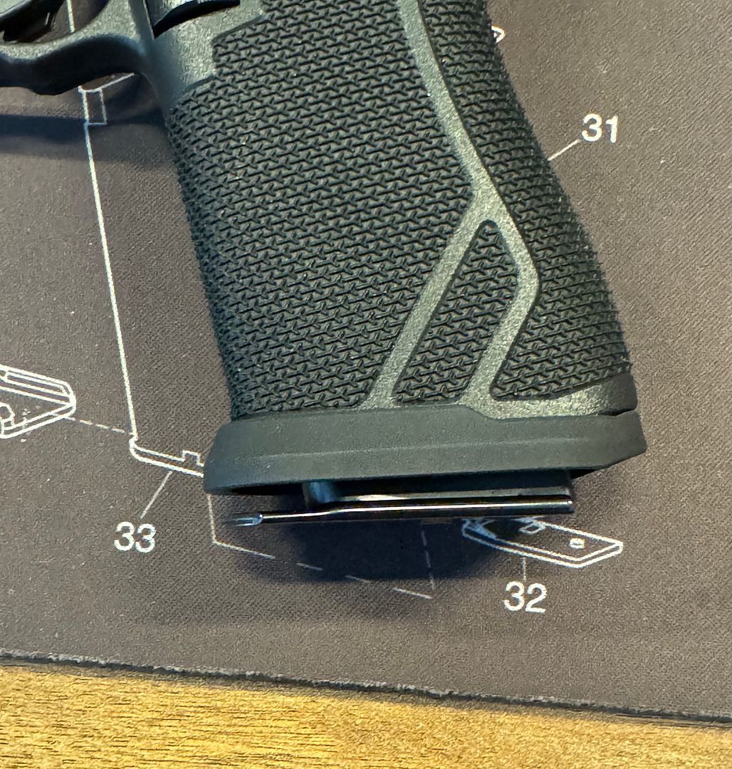

I tried the flat-steel P226 mag base today on my 43X 15 rd mag.
The holes don't line up on the base plates but it does fit on the Glock mag, although with a tad of wiggle.
I can't get the P226 mag insert on the spring of the 43x because of the curvature of the spring wire.
I simply placed the P226 mag insert in place and put the baseplate on it.
It fit and was secured with a little gap.
Keep in mind I have a Grit Grip frame with their magwell.
I'm too lazy to dig the 43X frame out of the closet.
I didn't shoot the gun with the modified mag, I was just seeing if it fit.
I don't really have an issue with the stock Glock base with the Grit grips frame and magwell.

I don’t have issue with the Glock-Gar G43X mag length. That said a true flush 13 rounder would have been great.
As for the SLR pad the pictures are with a magwell so I doubt it is a $35 improvement so to speak.

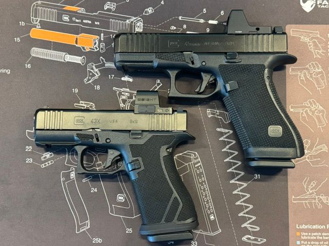

Popped into my new favorite shop today to get an NFA engraving done. Yeah, I know. Don't care. Anyway, I caught sight of an FDE G43X MOS in the counter and asked to see it. Sure enough, Glock did another run of the model I missed out on last year that's essentially a miniature 19X. No Cerakote, but the same molded polymer color and the same (Pre-19XV tan and not gold) PVD finish on the slide. Also comes with two of the new 15rd Mec Gar/Glock OEM mags.
I've been on the fence about getting the slide cut on my 43X anyways, since that's starting to take it from the good deal I got it for into "I could just buy exactly what I want new instead" territory. Between the configuration and the new mags, I went ahead and put down half on it.
