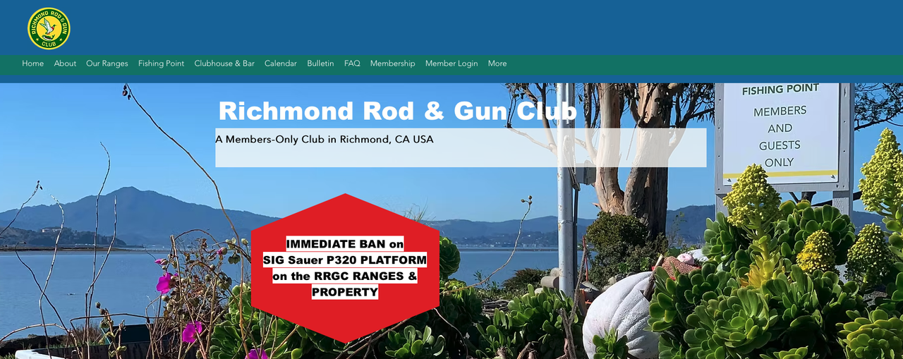

Saw this on another forum, the RRGC caters to competition shooters in the Bay Area.
