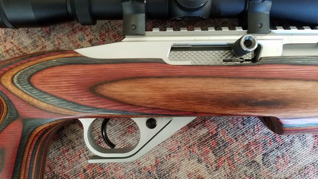

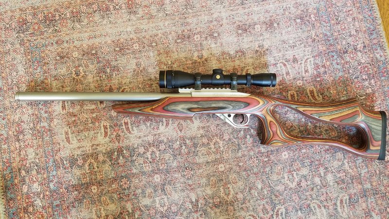

Kidd Supergrade, bought it maybe 7-8 years ago. Got an identical one in blue for my son. Leupold VX2 3-9 rimfire scope with A.O.
