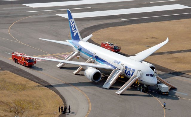

11A is right by the exit door, how in the heck do you get your seat belt off, get up and open that door and jump out that quickly...
That's an amazing story. Some people are capable of reacting very quickly under incredible stress.
There is no way that happened as written. Those doors are pressurized closed, even with engines failed there is enough PSI to keep it closed, there is usually a cover over the operating handle, then a very large handle that must be rotated a long way to open the door, then it swings in first to clear the frame, rotate and then pushes out, and it's heavy.

This article says "Reports reveal Ramesh was seated in 11A — an emergency exit row." He was NOT seated in an emergency exit row (usually located over a wing). On the contrary, he was seated right next to a cabin door - THE DOOR primarily used to embark and debark passengers. The cabin door forward of this one and in front of row one is only used if the terminal has two jetways available and is generally for business-class passengers.
The 787 has no wing exits. All of the exits are used in an emergency and I’d put money on the guy being given the spiel about being willing and able to help people out in case of an emergency. That’s enough for me to call it an emergency exit row.
