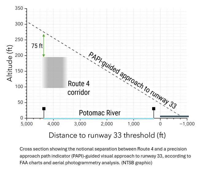

Plus or minus 25' according to the NTSB, so maybe 100'. Then take into account that's 100' between two points in space which aircraft are not. The CRJ had a 76' wingspan and was over 100' long. The information the DCA tower had for altitude was rounded to the nearest 100'.
The NTSB has said the Blackhawk was within the vertical walls of helicopter route. Is planning for 100' of serperation normal when setting the routes aircraft take? I knocked the plastic cover off the wing tip light on a 172 once pulling it out of the hanger. I was pulling from the nose wheel and it looked like it was going to clear. I was lazy and didn't open the hanger doors all the way which became the new rule for me. I can't imagine making that call at speed.

The radar altimeters in the RJ provide a good data point for the NTSB to compare the baro altimeters. They should be able to derive a very accurate altitude profile for the RJ.
TCAS provides good information to the crew about the traffic around them, with the caveat that altitude data is reliant on the other aircrafts' altimeter calibrations.
The last few minutes on the approach are extremely busy, especially with a runway change. They've just put gear down, the non-flying pilot is reading the Before Landing Checklist. The flying pilot is verifying checklist items by looking at the relevant switch or indicator all the while flying the airplane, looking at the flight instruments, scanning to look at the landing runway, and cross checking with the flight instruments. The non-flying pilot is simultaneously keeping an eye on the flight path and ensuring airspeed is ok.
Nobody has time to lock eyes on the TCAS. They could see the helo on the screen, and reasonably assumed they would abide visual separation.
There's no additional data or display that could have helped this RJ crew.

Runway 33 had an additional quirk: a particularly narrow vertical space between the landing slope for a jet and the maximum altitude at which helicopters using a certain route, called Route 4, could fly.
At its highest, near the Potomac’s east bank, the vertical distance between a helicopter and an aircraft en route to landing on Runway 33 would be 75 feet, N.T.S.B. investigators said. But if a helicopter were flying farther from the river’s east bank toward the airport, that distance would be even less.
That is one reason why, after the crash, the N.T.S.B. recommended banning helicopter flights on Route 4 when Runway 33 at National Airport is in use.
Jennifer Homendy, the N.T.S.B. chairwoman, said in a March 11 press briefing that those distances “are insufficient and pose an intolerable risk to aviation safety by increasing the chances of a midair collision at DCA.”
With so little margin for error — 75 feet or even less — it would be crucial that the Black Hawk fly below the maximum altitude for the route.
