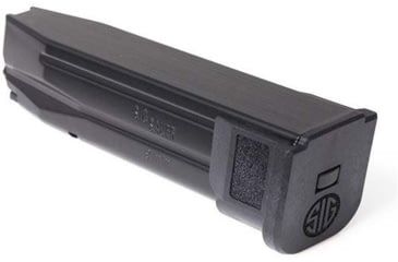

This is actually not correct.
The round hole 21 rounders have a sharp ledge where they meet the grip.
The square hole 21 rounders have a beveled edge where they meet the grip.
The beveled edge is required in order to fully seat in modern P320 (and likely P385) grips.
Random internet pictures:

^^ Hmmm, that's weird. When did SIG start putting round 'SIG' logos on round hole base plates? I've never seen one like that. If wrong, I stand corrected. Wink
I have one in my hand right now lol.
A couple years ago I went to replace all my rounds with squares - but sadly miscounted and I still have this one old round sitting around.

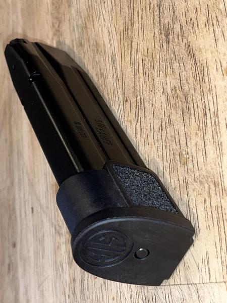

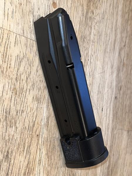

Pulled these five 21 round still new in their plastic wrapper magazines and thanks to you guys I just tried and learned that they will NOT lock into my P320X5 mag well.
What a huge disappointment it would have been to learn this at a later time on a range trip or when trying with my future P385. Here is a photo of what I have and because of the great folks on this forum, this problem is fixable.
I will get five replacement base sets ordered and while waiting for their arrival I will try my luck with my Dremel tool Big Grin. Just happy as heck that there is an affordable fix with factory replacement bases.
Again, THANKS Guys for your guidance, information, and recommendations.
