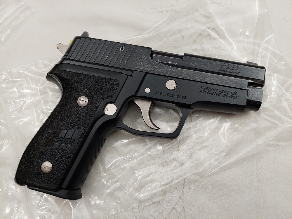

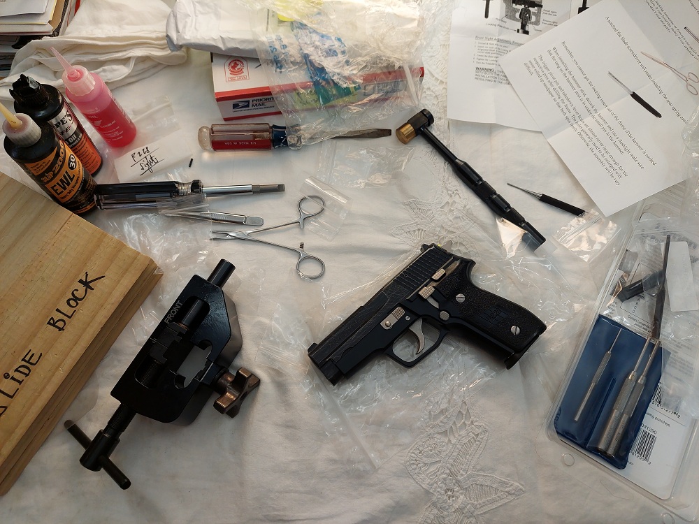

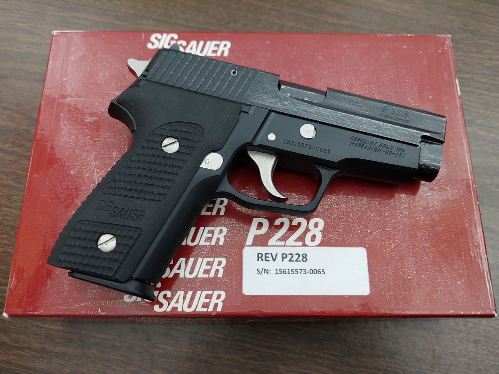

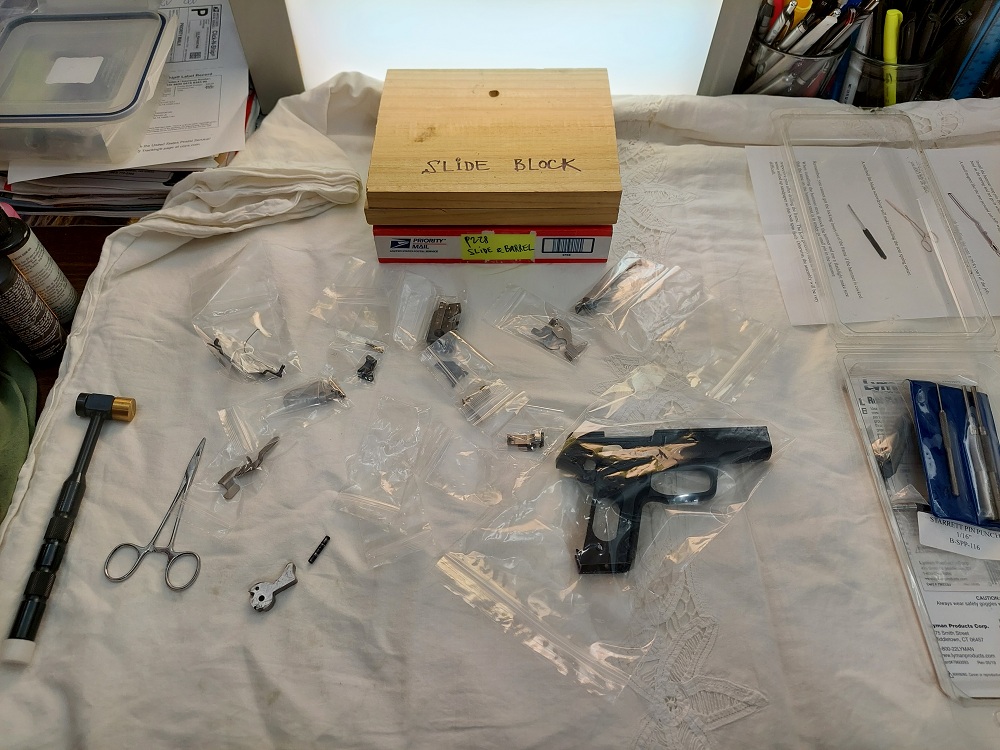

Those who like to tinker or build FrankenSIGs probably know Matrix Precision has been offering small parts and 80% frames for some time now. But they have stepped up and now offers complete frames. I just received one of their 228 frames, named REV228, "REV" for Revenant Arms, and the quality is first-rated. Finish is hard anodized, and the only way to tell the difference between it and the original factory frame is the REV228 has a subtly more squarish and more robust looking trigger guard. I had an orphaned complete P228 upper hanging around and the complete small lower parts from the cracked P228 Nickel from 2019. So, the result is a completely "new" gun, the REV P228. Everything fit perfectly, and frame-to-slide fit is pretty tight. All functions checked out. Test firing soon. Cool

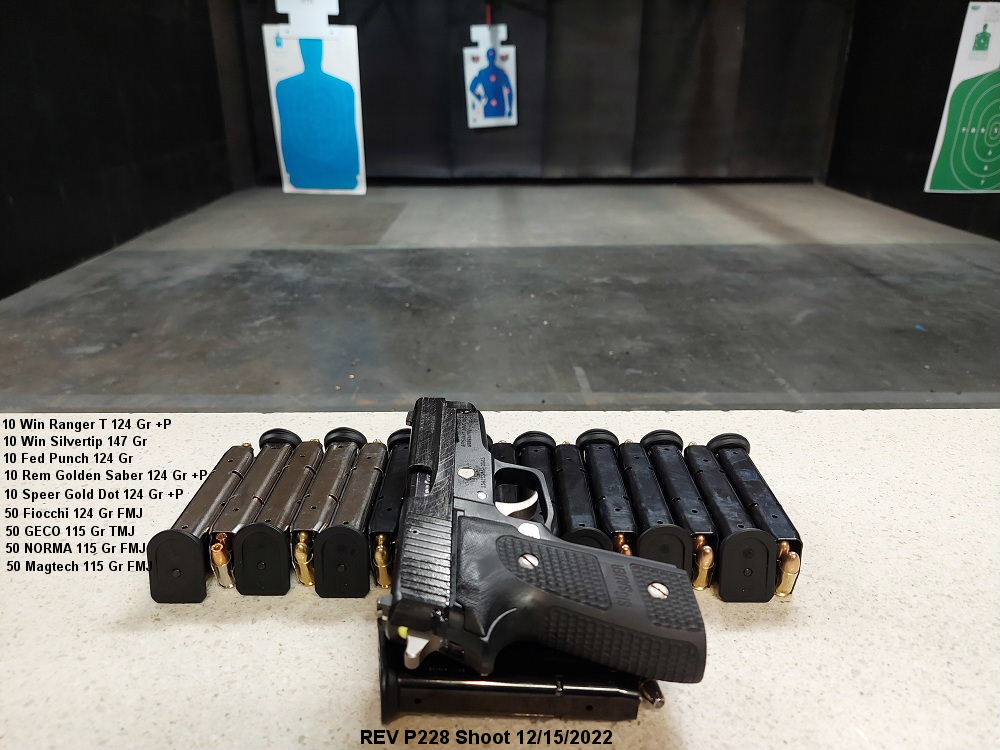

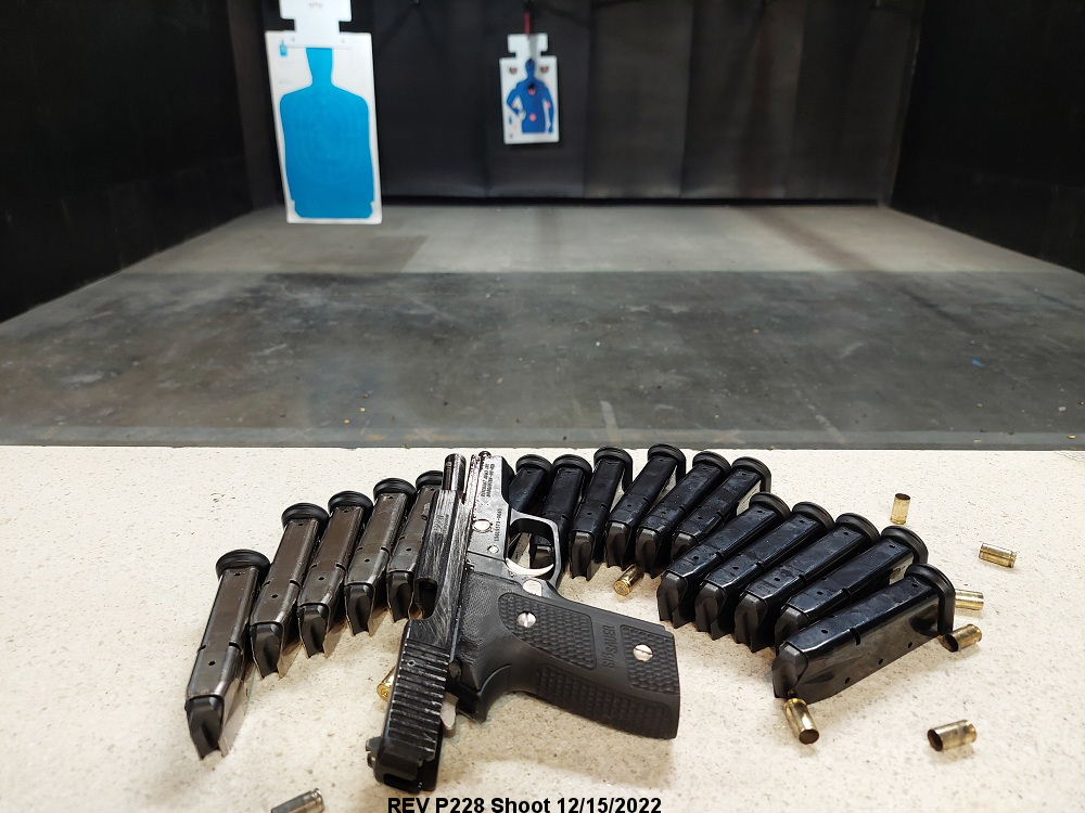

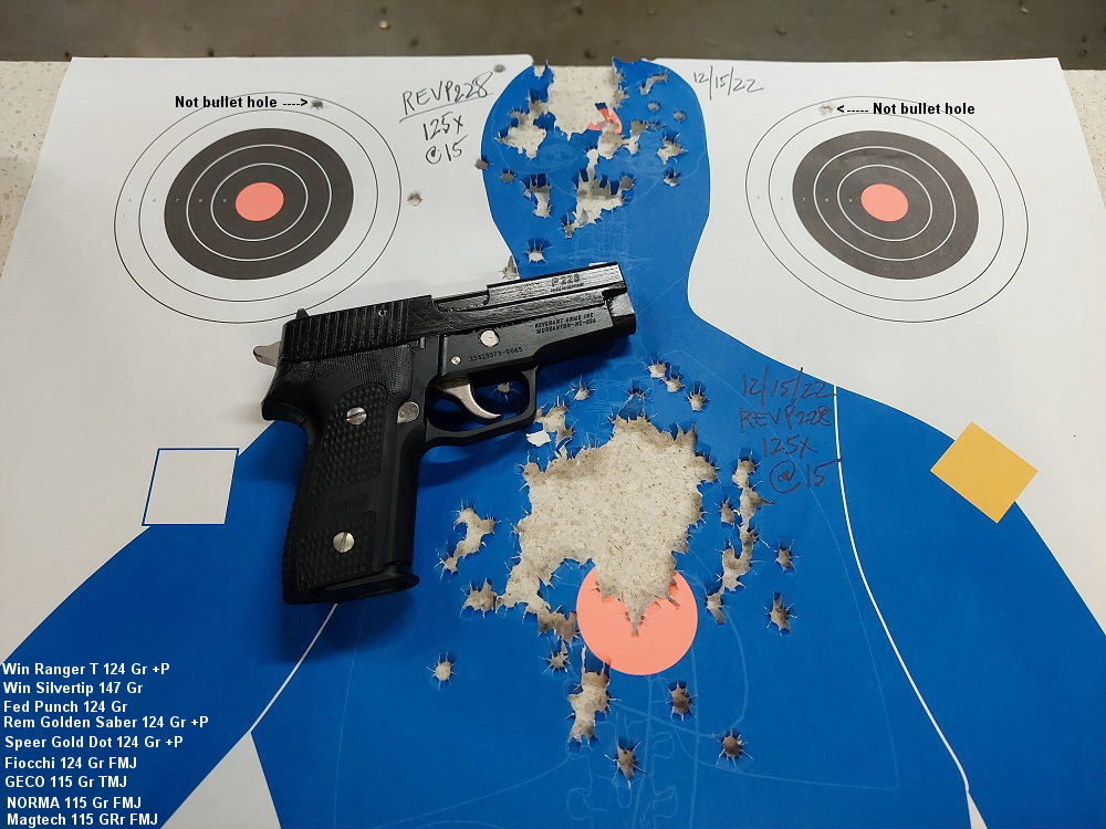

Knowing the stock plastic grips, being too squirmy, were not going to give me a good session, I swapped them out right away for the Hogue G10 Piranha grips. Preloaded all the mags with 250 rds of various brands, weights, pressure and configurations. Onto the range. Went through them in a flash. Not a single hiccup. The old action is smooth and fantastically crisp. What a great day it was. How can it not be great, shooting this obsolete gun? Big Grin

Please tell us more about the two wood pieces labeled 'slide block'.
Just my way of quickly making the slide block for the folded slide using some spare wood laying around. The 2 pieces are screwed together into one. And the hole you see on top is for tapping out the 2 breech block roll pins from the slide.

Question: Was the sear spring seat pin pre-installed or did you install that yourself? I have detail stripped classic Sigs several times and this is the only part I have never installed because I have never removed it. I have a new one and plan to install it as the first thing I do if needed.
It came pre-installed, which is a big plus. You can see the sear spring seat spin from the old gun sitting all alone in the 3rd pic (right between the screwdrivers). Big Grin
