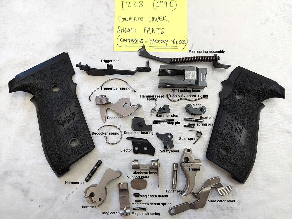

Awesome project to keep the small parts from that cracked P228 Nickel "alive". The only parts not used in the frame rebuild were the Locking Insert (LI) and sear spring seat pin.
What LI did you end up using? Was it the newest revision like those found in the Legion P229 SAO?
Thanks for sharing this experience, I appreciate the details describing this project that ended so well!

You want to hear something most interesting about this project? It almost didn't have a chance to get of the ground. I actually put up the entire lower parts set for sale a few months ago at a very reasonable price. But it didn't sell. So, I just put it away, maybe to try to sell again at a later date. Well, as it turned out, I'm thankful it didn't sell. I have 2 spare locking inserts that came from some old P229(9) marked by "29" on top. So one was used for this build.

I received my Matrix frame earlier this week. I haven't had time to complete the assembly yet, but I have fitted the magazine release and hammer stop and I test fit both Sig factory and Hogue G10 grips with brand new factory grip screws. All the parts fit perfectly. The frame is very high quality.
I'm using a combination of GGI parts that I had on hand and new OEM parts. Matrix does sell a complete lower parts kit of parts they manufacture for a very reasonable price, but I decided to buy factory parts for the ones I'm missing. Matrix includes a sheet with some notes about parts fitting and the document mentions that the trigger and takedown lever holes may need to be lightly sanded but based on the fitting I've done I shouldn't have to do that.
I hope to have it together by the end of next week, but I may not get to shoot it before foot surgery takes me out of action for weeks, unfortunately.

I just finished my Revenant Arms "2296" "build" today. I hope to get to the range on New Year's day to shoot it. I used a P229 Pro Cut slide and a combination of Grayguns and factory parts. Everything fit together with no problems. I also just received a set of the Hogue P226 Contour Classic G10 grips and put them on. They are super nice grips. I have other Hogue G10s for the 226 and I think these are the best of them all.
I'll try to get a couple of pics up later.

I finally completed my "2296". I'm not a good photographer and the depth of field is pretty shallow but you get the idea.
I am using the GGI ELS, strut, mainspring seat and SRT. All the other parts are factory except for the extended mag release from Matrix Precision. I know the Pro Cut slide is not everyone's cup of tea but I already had it and a Romeo 1 Pro, DPP and SRO.
I put 180 rounds through it with the R1P mounted; 50 RA9T and the rest Blazer Brass 115gr and my 147gr reloads with no issues at all. I used 3 different magazines, new Mec-Gar 18 round, Mec-Gar marked 15 round and some older 15 round dovetail phosphate magazines.
I plan to shoot matches with it this year. It fits a JM Custom kydex holster made for the 229R.
