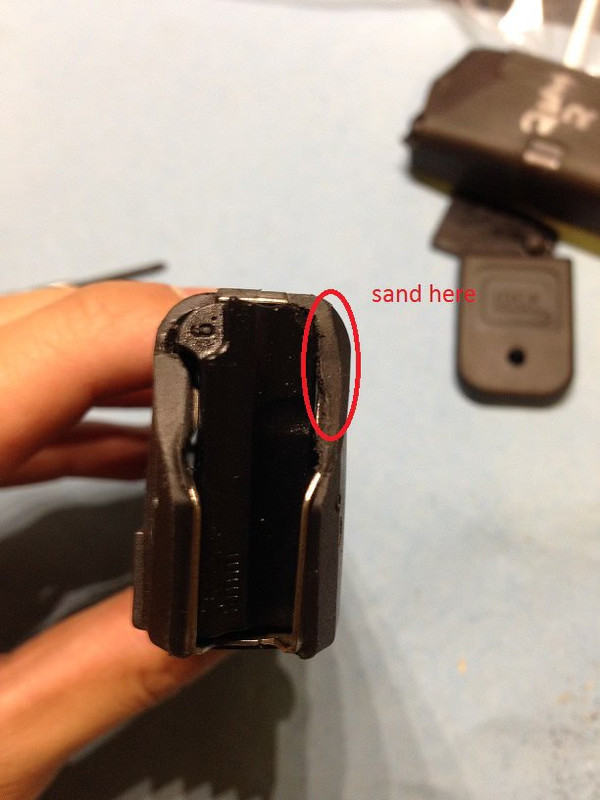

The 9mm3 are direct swap while the 9mm 6 requires you to shave off a sliver of plastic off the inner corner of the mag tube. Literally takes 5 seconds with a razor blade.
When you stick a 9mm 6 follower up into the mag tube, you will see exactly where and why.
Not my pic, but shows where to shave it. Again, I used a razor blade and not sanding.
The 9mm7 will be the same as 9mm6. I'm sure I have a mix of both, and never noticed anything different.

Awesome - thanks for the info! The pic is very helpful.

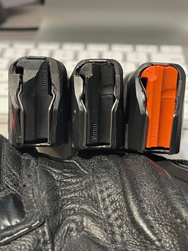

Here's a pic of one of my 10 rounders with a 9mm6 and the orange one is a standard cap.
The one of the left is a G17 10 rounder with a 9mm3 follower. Notice the extra plastic from the unmodified mag tube compared to the modified 9mm6 mag and the standard cap.

Excellent pics. And I like the orange follower.
