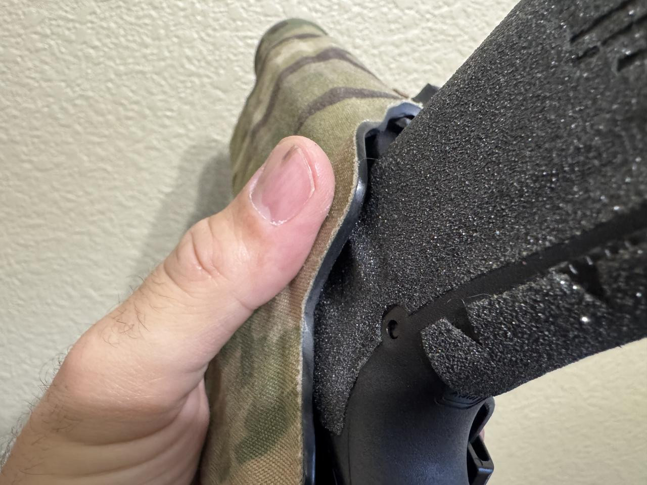

Here's a 6360RDS with a P320 W/ TLR-1 in it. In the pictures my finger is bottomed out against the opening, and is not touching the trigger. Yes, I can force it in there, but it takes significant force as it has to bend the plastic. Does it provide perfect, 100% protection for the trigger? No. But it's not a gaping maw, either.

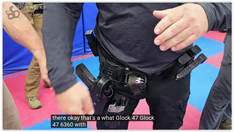

When in fact, my unit points guns at people almost daily. Gets into fights at least a couple times a week. And there are zero problems with the 6000 series and Glock. You’d think if the problem was with the holster, it would show up widely on the street. Matter of fact, I don’t know of a single incident statewide. And the 6000 series is king and the state is 80 percent Glock. Not a single instance. Not. one. And yep, I have had people try to disarm me as recently as last month in a fight with a guy high on ‘shrooms.
And most of the social media influencers that bad mouth yhe 6000 series also strangely seem to be sponsored by Alien Gear. Weird, no conflict there.
1) This is the WML Gap issue
2) It is not specific to a particular holster or gun
https://youtu.be/dic5q1mz9_g?si=3HQ7DFLZh5kKMk6y

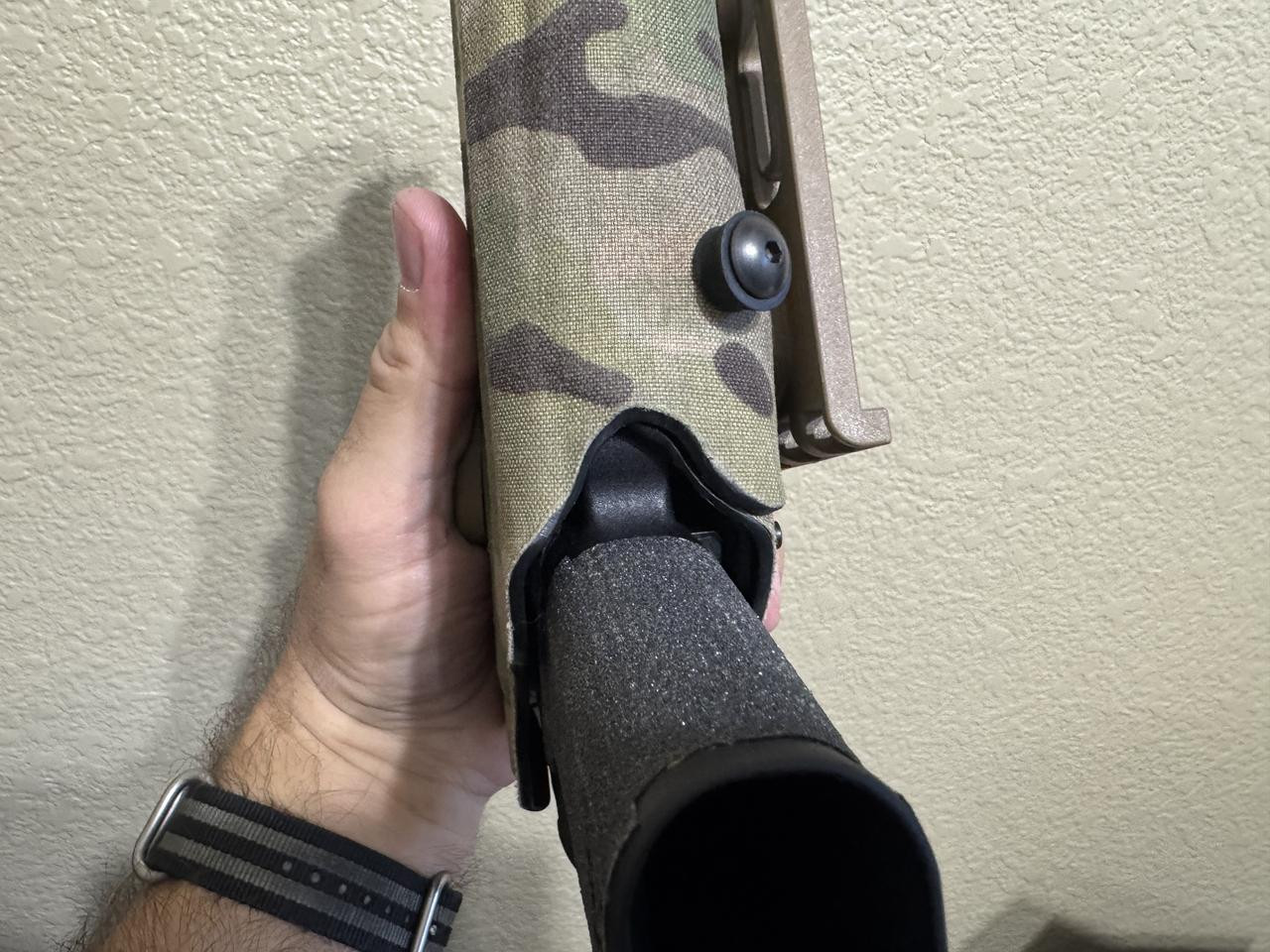

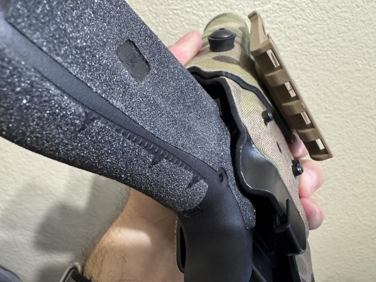

I wish my Safariland had a gap that size. Maybe mine was made on a Friday right before shift ended. Maybe I should have contacted SF at the time and tried to get them to replace mine as defective. Safariland isn’t the easiest company to deal with though so I doubt that would have worked. I’ll try to post a pic of a gaping maw.

So, a couple things here. Clearly, the RDO series is different from the RDSO series, and the iterative changes they made that very clearly cover and protect the trigger and trigger guard. There's a TLR-VIR II under there, fwiw, so broad brush statements about "gun bucket holsters" and "gaping maws" and "cavernous" openings on these types of holsters don't do much for honest conversation IMO. I have no doubt that some of the older Safariland models weren't as well protected, but clearly with the newer ones, you're not getting a finger in there unless your hands are so small that you have no business trying to work a handgun in the first place.
Posts: 19368 | Location: Sonoran Desert | Registered: February 10, 2011Reply With QuoteReport This Post
Yeah that clearly closes up the gap significantly.
Posts: 12184 | Location: In the Cornfields | Registered: May 25, 2006Reply With QuoteReport This Post

I resent the pics to 92fs. So apparently the DO stands for Directly Open to anything or some such. Glad to hear the newer holsters are better than my POS.

Here are pedropcola's photos. I agree, that's pretty bad Eek!

I can assure you that is not a knockoff. They made them huge. Like I said before, I’m glad they pulled their head out of their ass. How many holsters like mine though are still floating around out there?
I own a dozen SF holsters but I have never bought another wml version from them.
Thanks 92fs.
That's definitely the worst I've seen.
Posts: 35677 | Location: Northwest Arkansas | Registered: January 06, 2008Reply With QuoteReport This Post

I should have gotten my money back. At the time I thought they all were like mine. Ugh.

Yeah that’s not right. I just tried 3 different holsters , a 6360RDS and two 6280RDS and I could barely stuff my finger in past the finger nail. Pulling the trigger was not an option and I don’t have big hands.
________________
I don't know, but yours is the only one I've ever seen that looks like that. I get that you're forming an opinion based on your sample size, but it's a seriously fucked up sample. Razz
So is pedropcola’s holster defective? Is it not possible that there are other holsters of this model that were made the same way?
If something dropped into that gap and pulled the trigger when retrieved would that be the gun or the holster that allowed it to happen?
