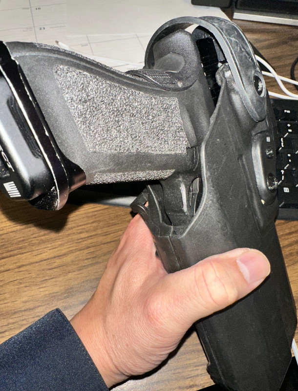

Yup. Rough handling ain’t lighting these off. Pulling the trigger is. In every single instance to date they have yet to make one of these just go off. Internet boogeyman indeed. It might be a poor choice for many but for fucks sake stop with the it just went bang lunacy.
THIS is why...
It's a real puzzler as to how something other than the P320 might get in the holster! Roll Eyes
These are pics of a Safariland 6000 Series Duty Holster for a P320 with Weapon Light. All manner of shit can get in, fall in, and/or potentially get lodged in there and interact with the trigger, to include jackets, zipper pulls, shirts, keys, seat belt buckles, coins, pens, small fingers, flashlights, and the list goes on...You name it! To borrow a familiar and overused phrase, 'you could drive a truck through there'!
The previous pics were stolen from the following thread:
https://sigforum.com/eve/forum...0601935/m/5860055215
At this point, this issue clearly seems to be occurring exclusively with 'holstered' P320 Pistols. If it were a P320 issue, we'd see discharges occurring in other circumstances...Except we're not! It's NOT rough handling, something is depressing the Trigger!
Posts: 11357 | Location: New Hampshire | Registered: October 29, 2011Reply With QuoteReport This Post
For real?
Picture of Chowser
Yeah, 6000 series were bad for this. The 7000 series isn't much better.
This is my 7360 holster
Not minority enough!
Posts: 8824 | Location: Cleveland, OH | Registered: August 09, 2007Reply With QuoteReport This Post

Absolute bullshit Jupiter. I have described in this very thread that I own a very expensive, very nice, high end Safariland ALS holster. It a 6000 something for my G19 with an X300. I spent a small fortune on mine, fabric wrapped, it’s awesome. And I put the gun in there one time and instantly said “nope”. I even tried to sell it here at a massive discount and it didn’t sell. I haven’t carried a live weapon in it a single time. If somebody deserves to be sued, it is Safariland for making a wildly dangerous holster for duty use.
Those wml holsters are awful. If I was a cop I would never carry one that looked like my top shelf Safariland. Fully holstered I can stick any finger, thumb, any object in fact, into the gaping maw that is there.
Are you so determined to be right in this thread that you actually believe Glock leg went away? That ND’s with Glocks don’t happen because of the magic dingus? That’s stupid bullshit and you know it. The trigger safety helps. Helps a lot in fact. It isn’t magic though. Glocks ND plenty as 92fs stated. Nobody is wasting their breath though reporting that on tik tok because nobody believes when a Glock goes off now that it wasn’t a simple ND caused by inattention or complacency or bad gun handling. A 320 goes off and a band of guys like you instantly act like it just went off even though no one has produced a single fact to back it up. Just stop. Or don’t I guess, but you sound like an 16 tik tok influencer every time you repeat the internet mantra “320’s just go off”. (and yes that is exactly what you have implied multiple times in this thread)
Cops want weapon mounted lights. There is no way to make a holster that fits tight enough around the trigger guard to prevent something from getting in there and a P320 from firing. I’ve said it before, Safariland needs to quit making holsters for the P320. At the very least, for weapon mounted lights. As should every other manufacturer.
Or, Sig needs to admit the idea of a cocked and unlocked duty pistol is maybe, not the best idea.

Kinda like this, pedropcola?
I was able to pull the trigger while fully holstered with my finger, a pen, and a seatbelt with this Sig supplied holster. It's not even a WML holster for God's sake. If Sig is on record talking about the massive hole being a safety issue prior to including POS holsters like this with their pistols, they have a problem. Could it be that Sig isn't concerned about the civilian market because police officers are the only ones that have fingers, pens and a seatbelt in their car?
I'm implying that the trigger on a P320 is too easy to pull.
Some of us know the difference between Glock leg and what is being reported and caught on video over and over and over again with the P320.
