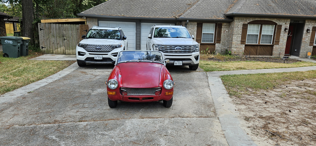

Small family photo
Posts: 18984 | Location: Spring, TX | Registered: July 11, 2011Reply With QuoteReport This Post
Looks like it's grinning! Smile
I know I sure was.
Still driving with a keen eye on the gauges, but it's running well. May drive it to work this week & give it a freeway workout.
