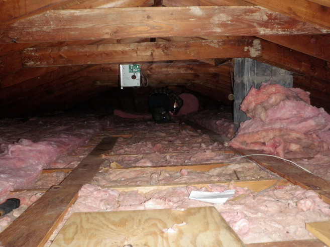

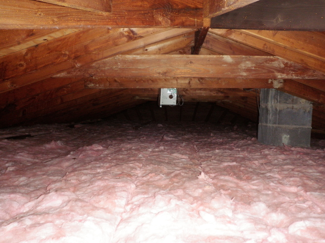

We had the same problem in our 1300 sq. ft. ranch, built in the mid-60's. After the new roof was done I went up there and added another 6½ inches of fiberglass roll insulation at right angles to the existing fiberglass roll insulation between the ceiling joists.
I kept it down to only another 6½ inches, and used fiberglass roll, so I wouldn't have to deal with soffit vent baffles, which would've been a royal PITA to install.
Before and after...
There was even a spot up there, other side of the chimney, where there'd been no insulation at all! Best guess is it had been removed when they added the addition, then they neglected to put it back.
