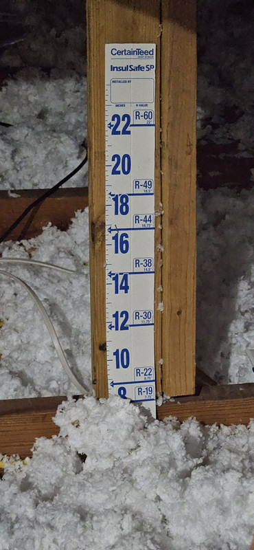

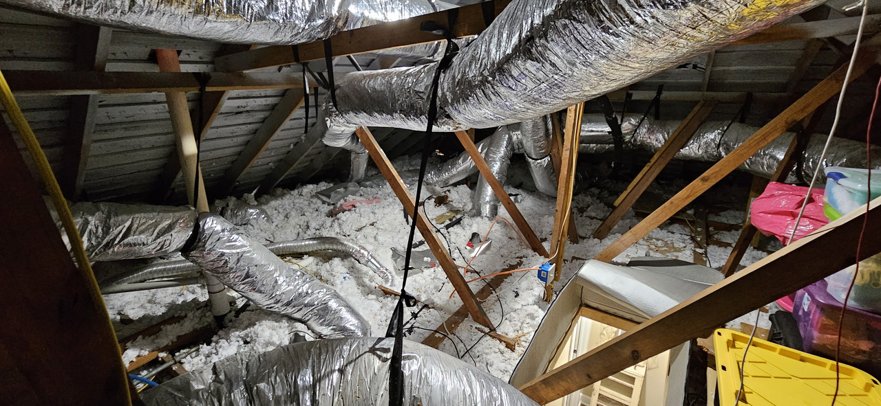

A few attic photos. Looks like we have full length soffit vents, at least in the front, where they're more easily visible [from the attic]
