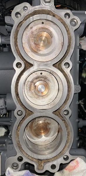

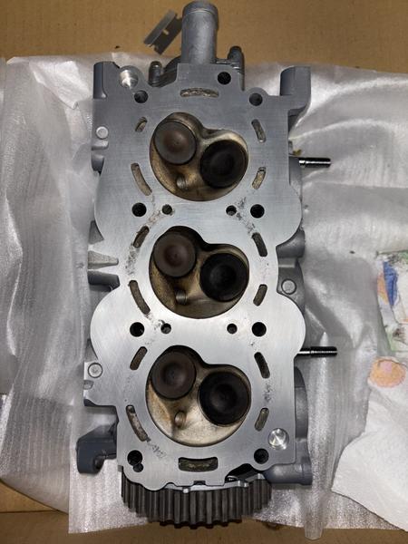

I don’t think I can see .002” anymore if I ever could. I ordered a straight edge yesterday and it should be here today. I’ve done clutch covers on motorcycles, but those aren’t that critical. I might have a 25 year old tube of Yamabond in a drawer somewhere.
Update:
Got home and the machinist’s straight edge and feeler gauges were on the porch.
My head is not warped.
