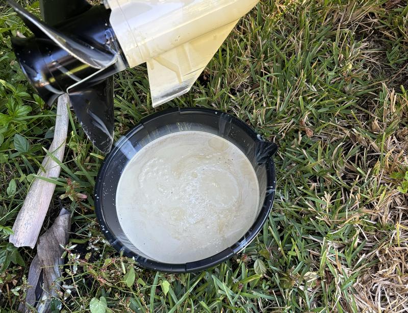

After the engine is run, check the oil not only as soon or as feasible afterwards, but after it has sat for at least a few hours.

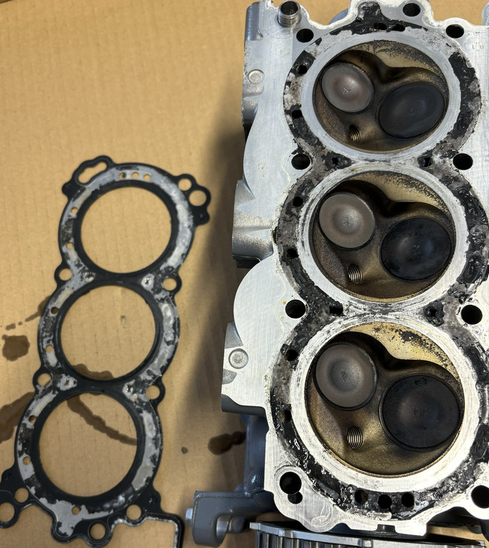

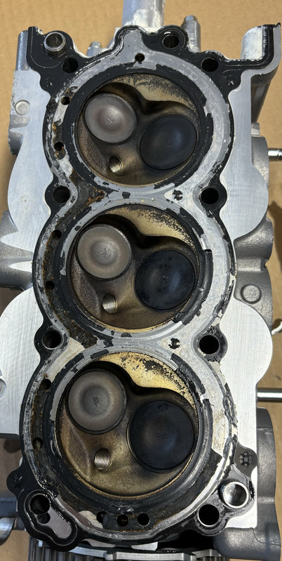

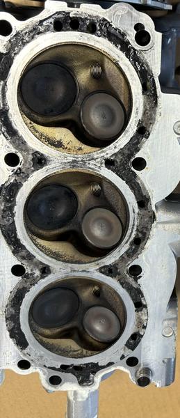

^^^That graphic is great! I really thought it was going to be useful once I pulled the head. Here’s what my gasket looks like:
The only thing I can tell for sure by looking at my head gasket is that I shouldn’t reuse it. I’m in new territory here, so I have no clue what I’m looking at. The cylinder walls look good though; beautiful cross hatch pattern and no scoring.
We’re going to clean up the mating surfaces later today. Probably going to order a machinist’s straight edge to see if the head is warped. Seems like a substantial casting compared to a two stroke head.

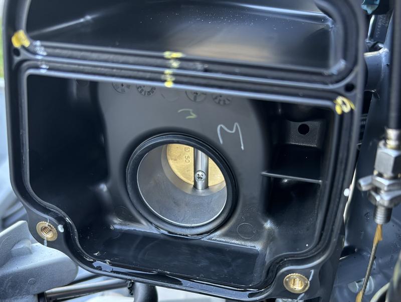

My son said smoke, probably steam, was coming from the back of the engine cover where air gets sucked into the intake. There was a pool of water when I separated the air filter housing from the throttle body. There was nothing unusual around the exterior perimeter where the head mates with the block.
We would have had it off last night, but the tools I bought my son didn’t have an 8mm 12 point socket for the cylinder head bolts. We read the service manual, then skipped half the steps. The service manual said remove the flywheel, stator, camshaft, and the entire powerhead, before separating the head from the block. I couldn’t see any obvious reason to do all that other. Hopefully it doesn’t bite us in the ass.

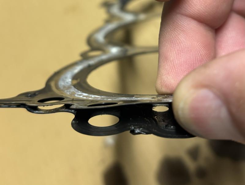

New question: how many layers is a head gasket supposed to have?:
Posts: 14629 | Location: SWFL | Registered: October 10, 2007Reply With QuoteReport This Post
^^ It depends. Multi-layer gaskets do exist and designs vary by application and/or manufacturer. They can (and often do!) separate when removing the head. You 'may' find the the point of failure somewhere in there though.

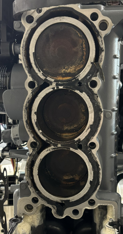

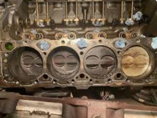

Typically, if there is water entering the combustion chamber, it will have a "cleaning effect" in that/those cylinders. (water, methanol/water, and/or petroleum distillates is a main method of cleaning without disassembly.
The affected holes will have clean combustion chamber/valve faces, piston dome.
https://www.wootmonkey.com/upl...9092717-b1350b5b.jpg
Leaking from coolant/water jacket into oil passages/sump will create the milkshake, and may not have entered any cylinder(s), and can be from cracked head, block, head gasket, intake gasket, or even induction (swamping in a boat or vehicle through water, high speed, off roading)
Looking at the head, I would rule out anything entering the cylinders, but gaskets or crack in block would be the focus.
Almost certain if there was a lot of water in the air induction area, that it may have swamped that are.
Is there any venting/crankcase breather other than the induction where steam from the crankcase from moisture would be in the area of that engine cover?
If not, that leads to asking if they think it may have had a "big drink" while they were out boating. (part of boating is learning what not to do when boating)
I'd clean, inspect what I could, put it together and take it out, stay near the marina and put it through the test.
Posts: 46499 | Location: Box 1663 Santa Fe, New Mexico | Registered: December 20, 2008Reply With QuoteReport This Post
There is. I don’t have a good picture of it, but there’s a large, 5/16 maybe 3/8 ID, hose going from the top of the cylinder head cover (valve cover in non-marine terms) to the back of the air cleaner housing. Also, the runner that goes from the hole in the back of the engine cowling to the air cleaner housing that feeds fresh air. This is the water:
Nothing after the throttle body was wet though; each intake runner is at least 10” long. I taste tested it and it wasn’t saltwater.
I have a theory that works with the steam cleaning and the point where the head gasket is separated:
In the picture, the head’s entire mating surface is evenly coated with black residue from the head gasket which matches up with the water jacket around the cylinders themselves in the block except for the two points at the bottom by the two bottom cylinder head bolt holes. The third hole in the middle is an oil passage between the head and block. The part of the head gasket where the two layers of steel separated was between those two head bolt holes.
I’m thinking once they put the flush port plug back in and restarted the motor, then as the block started to fill with water, some of the water turned to steam and the pressure shoved the water at the bottom through the head gasket at that point right into the oil sump. Condensed steam would also explain the puddle of freshwater in front of the throttle body.
On another note, the local Suzuki marine dealer had the head gasket in stock. They had to retrieve it from a bin stored in the attic, but they had one. It is two layers of steel.
Part of me wants to slap the whole thing back together. The other part of me says order the machinist’s straight edge, wait until it get’s delivered, and then make sure the head isn’t warped.
