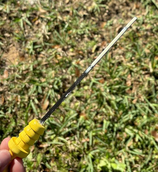

I think my boys blew the head gasket. Yesterday, they took it out for 45 minutes. They called me 10 minutes in to tell me the over heat warning light was on and the motor went in to limp mode. I asked if the motor was peeing, my son looked and that’s when he realized he forgot to reinstall the flush port plug after flushing it the day before. He put the plug in, I had him wait 10 minutes before restarting the motor, he said the light was out, and they ran around a bit. They both thought the motor was running fine.
I checked the oil this morning and it seemed fine. They went out for a couple of hours, said it ran fine, but when we flushed it using the flush port (motor not running of course) water seemed to be coming from places I never noticed it coming from before. I pulled the dipstick and the picture in the first post is what I found.
I’m thinking the head gasket is blown. I have a big garbage can I could run a hose into, but should I really do this before fixing the head gasket?

Bought my 15yo a set of tools, a jug of Supertech 0w-16, and a $3 drain pan. The first drain:
Spark plugs looked perfect, so we filled it with oil, pulled the rope a bunch of times, put the spark plugs back in, ran it for 10 seconds and drained it again. Still some milky crap came out towards the end. We filled it again and are going to let it sit until after Christmas.

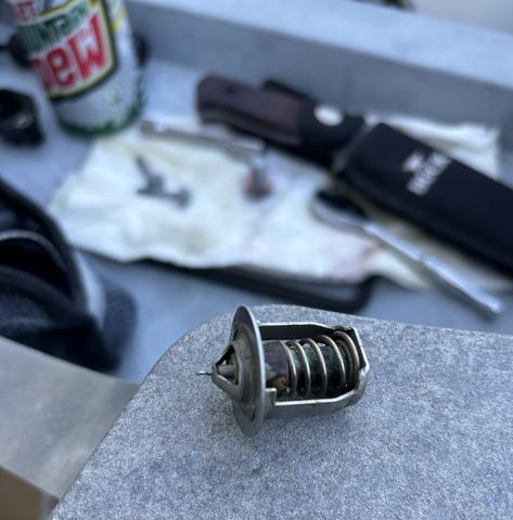

Checked the thermostat as well. It looks good and isn’t stuck open. Opens in boiling water and closes in cold water.
