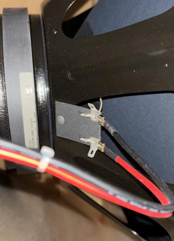

Fixed! I talked to Klipsch and they OK’d me taking the crossovers out to see what was what:
It turns out that just swapping the jumpers around on the outside of the low frequency cabinet is not the same as hooking the woofer up properly in the first place. Swapping the jumpers put the two woofers in phase, but it also meant the signal going through the woofer portion of the crossover was out of phase with the signal going through the midrange and tweeter portions of the crossover which really messed up the sound coming from that speaker. Now that all the wires are going the way they are supposed to, I’m getting goosebumps listening to them.

Glad you got it straightened out, those are some spectacular speakers. Did the techs say anything about how the mis-wiring might have happened?

joel9507 got it. Cool Dark Side of the Moon is great and certainly worthy of listening to, but the wall is brick. Confused Big Grin Actually, I just looked at the pictures and realized at the resolution I posted, it isn’t as obvious as it is in my mind that the wall behind the Klipschorns is brick. It kinda does look moon like in those pictures. Frown
I sent the Klipsch customer service guy the pictures. In an email, he just said great and he would close the ticket.
