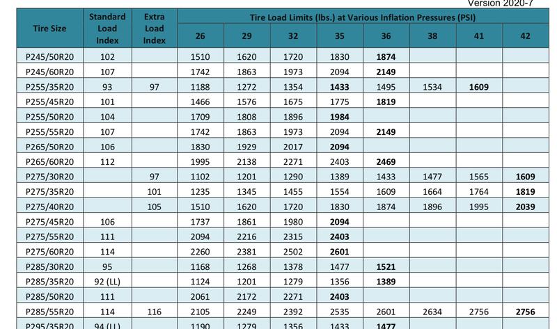

Thanks. Tire size is 285/55/20. I need to go look up the weights again but the recommended pressure based on max load limit is already known - 42psi. What I may need is actual measured weight in daily driver mode (I'm guessing curb weight + 500lbs?) vs the recommended max load capacity. Then maybe find the pressure for that? That may bookend things (not necessarily that I would use that pressure). So, if the vehicle is driving around with 7000lbs (vehicle + passengers), then seems like a pressure of between 35-40psi would be okay - don't need 42psi.... Whether that would be better or worse for responsiveness and traction is tbd, but at least should be okay from a load safety perspective. right? "Wrong does not cease to be wrong because the majority share in it." L.Tolstoy "A government is just a body of people, usually, notably, ungoverned." Shepherd Book | |||

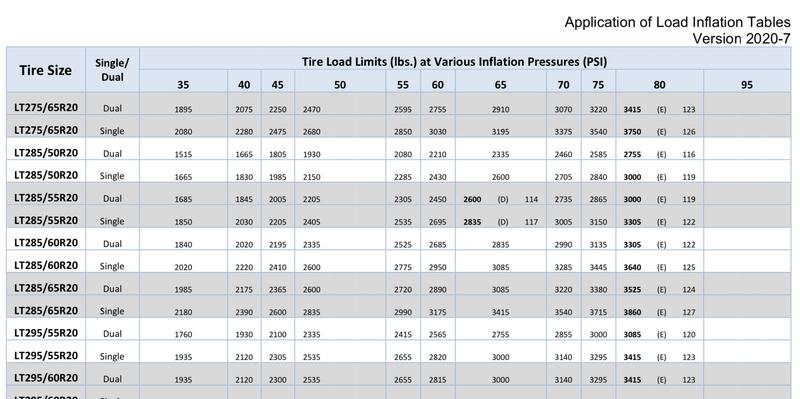

42 does not apply to the tires you have installed. You said you have load range E tires which means your tires are LT285/55R20s with a max cold pressure of 80PSI, not P285/55R20s with a max cold pressure of 42PSI. Looking at the charts below, you’d need a little over 60PSI in your LT285/55R20s to match the load carrying ability of a P285/55R20. You can go as low as 35PSI with your tires as long as they are not carrying more than 1,850 pounds each. While that would a total of 7,400 pounds if your tires are evenly loaded, the chances are the front tires carry more than 50% of your vehicles weight when your vehicle is empty. | |||

Thanks - I'm probably confusing things by referring to "max" load, etc. Which is probably wrong and I shouldn't have done that. Sorry for the confusion. I'm not looking at max bookends here. I don't have the numbers handy but basically 42psi is the right RCTIP for my car and the LT285/55/20 tires based on the stock p-metric tire pressure of 33psi(I think). This is the number the shop, I and others with the same car independently determined. 42psi is not in question in this context. Again, you're probably right for "max" contexts but I don't think that's my context here. Again, sorry for any confusion. My context is basically an empty car + full gas + passengers. No cargo, no towing, nothing else the car is capable of doing. With stock P-metric tires, the shop would fill to 33psi per the tag in the door jam. With LT tires, the shop fills to 42psi (except when they make a mistake and only fill to 33psi). Or per the tables you have, if stock is P285/55/20 at 33psi, then the load in context is about 2400lbs. Moving to the LT285/55/20 table, then the corresponding pressure would be (2400/1.1 = 2181) roughly around 43psi. But I'm not carrying around that amount of weight. Hence the question: if I'm only carrying around 6000lbs, what tire pressure can I safely use and what difference, if any, will it make to traction? Seems like 35psi should be safe from a load perspective with headroom to spare, right? "Wrong does not cease to be wrong because the majority share in it." L.Tolstoy "A government is just a body of people, usually, notably, ungoverned." Shepherd Book | |||

The chart shows 50PSI in an LT tire your size will give the same load carrying ability as 33PSI in a P tire your size, about 2,400 pounds. Did you change tire size as well? 35PSI is the minimum you should run on the roads, if the actual weight on the tire does not exceed 1,850 pounds. I don’t know what affect running that low will have on your vehicle. I know that less than 50 in the rears on my F350 makes it feel like it’s floating on marshmallows. Are you sure your KOs are LT tires? They make those in both an LT tire and a P-metric in that size. | |||

I believe there is a 10% conversion / safety factor that needs to be accommodated when converting between Pmetric and LT tables. So a load of 2400 pounds in the Pmetric table is 2400/1.1=2181 when using the LT table. But don't take my word for it - please verify independently. But I'm pretty sure it's in the documentation that accompanies the tables. If you find something different or doesn't apply to your tables, let me know. But the tables I used indicated this adjustment. If 35psi is safe from a load perspective then, I'll perhaps experiment w/ handling in 2psi increments, going down from 43psi. BTW, there seems to be a 10% rule where, if after driving and getting the tires warm (say 30 highway miles), if the pressure by 10%, then the tires may be overinflated. If it goes up more than 10%, probably underinflated. More rough rule of thumb I guess. But I drive around and my tire pressure is only going up 1psi, maybe 2 (rounding error). If you believe the rule of thumb, then perhaps I have some headroom to let some air out. "Wrong does not cease to be wrong because the majority share in it." L.Tolstoy "A government is just a body of people, usually, notably, ungoverned." Shepherd Book | |||

You are right. When a P-metric tire is installed on an SUV/light truck Federal Motor Vehicle Safety Standards require the derating the tire by 10%. I didn’t know that, so thank you for teaching me something new. Yes, you should be fine lowering your pressure as long as the load carrying ability of the tire at the pressure you choose is above the actual weight on the tire which does include passengers and fuel. One thing about “ply rating”: it’s a really old rating that doesn’t apply anymore. Used to be a load range E was literally a 10-ply tire. There was 10 layers making up the carcass of the tire. Most LT tires have the same number of layers as P-metric tire: 2 ply carcass with 2 steel belts and a layer of nylon around the circumference of the tire. Some LT tires have a 3 ply carcass. | |||
