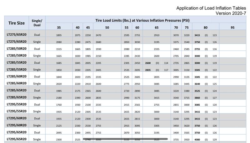

Did your vehicle come with Load Range E tires to begin with?
If not, the door jamb sticker will be wrong and you’ll have to look up the load inflation table for your size tire to find the minimum pressure required to carry your vehicle’s front and rear axles’ weight rating. If your vehicle came with P-metric tires and you put LT load range E tires on it, then it will ride stiffer even with the minimum required pressure. Most P-metric tires have a max cold PSI of 36 or 44 while a load range E tire is 80. The load range E tire is built stronger to contain air at that pressure.

I’m sorry, I got interrupted while posting and the No below was directed at konata88’s post three posts up:
No. The numbers from the load inflation tables are not recommended numbers. They are the minimum pressure required to carry the load listed for each PSI.
42 is not an answer on the load inflation tables for LT tires. I suspect you are looking at a P-Metric table.
Without weighing your vehicle, you are guessing what the pressures should be. An educated guess would be to use the front and rear axle weight ratings divided by 2 as the load the front and rear tires would carry individually and look up the PSI required in the tank for your tire size.
If you have the actual weights, look those up and don’t go below the PSI for those weights. For example, the rear tires on my truck call for 80psi at which the are rated to carry 3,750 pounds each. According to the CAT scale, the rear axle my truck unloaded weighs 3,300 pounds. That’s 1,650 pounds per tire. The lowest pressure on the chart for my tire, 35 PSI, says it will carry 2,080 pounds. I don’t like the ride and handling under 50PSI, so that’s what I use when not towing or loaded. I carry a compressor if I need more air.
Load inflation table, my truck’s tires are 275/65r20 single because it’s not a dually:
