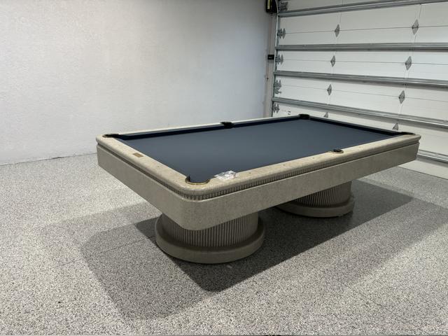

Picture of Georgeair
Consider flake options as well. Some were going to make it impossible to find a nut/nail/etc. dropped on floor.
In the end I went with a color called "Aubie". War Eagle!
{It's way more dispersed than in this picture}
Posts: 13681 | Location: Madison, MS | Registered: December 10, 2007Reply With QuoteReport This Post
