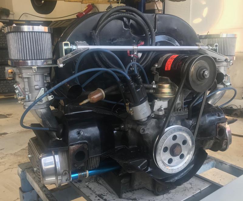

The problem was the starter, pulled the one off the green bug, and it hasn't had an issue since ... So now it's time to change more stuff, all the goodies have came in Smile
I'm going to pull the engine again and take the tin to have it sand blasted and repainted
the distributor with electronic ignition

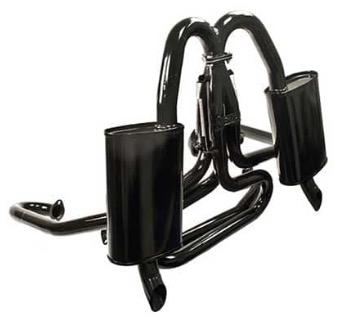

This is the exhaust, mufflers can come off when I want to play and put on a stinger

Today I only had a few hours and the instructions to mount the manifolds, carbs, air cleaners crossbar linkage. The instructions were on several pages and weren't well organized ... I'd take two steps forward, then a step back, then re-assemble, two more steps forward, then back ... But at least now I know better for next time!
I got the manifolds on and the carbs mounted along with the cross bar ... I'm not exactly where the coil is supposed to mount, but there is a bracket for it. It's in the instructions to remove it from the fan housing but I can't find anywhere in the text or diagram, where it's supposed to mount; but I'll get it figured out ... Then setup the linkage and fuel lines ... Put on my headers and slide it in ... Cross my fingers and hope it starts!

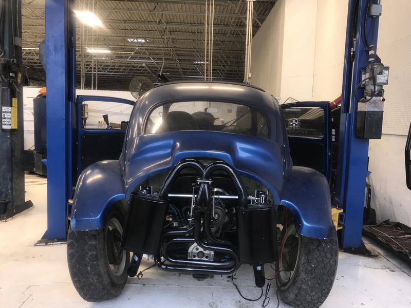

As has been fairly typical for this project, a complication has come up ... Last week I got the the engine back in, complete with exhaust, however when I went to install my rear bumper/cage it became obvious I could have the mufflers of my choice OR the bumper ... I was telling a friend about it and planning to make the bumper longer ... his response was to raise the exhaust above the bumper!
This isn't the final solution, but it works for now. I was able to take it on its first trip around the block (under its own power) since 2013 ... Still have to get the lights working before I can get a highway title.

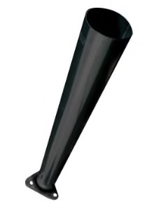

I didn't like having the mufflers above the engine cage so I put the stinger on it for now, until I get the cage extended to fit around the mufflers ... The stinger isn't too obnoxious.
