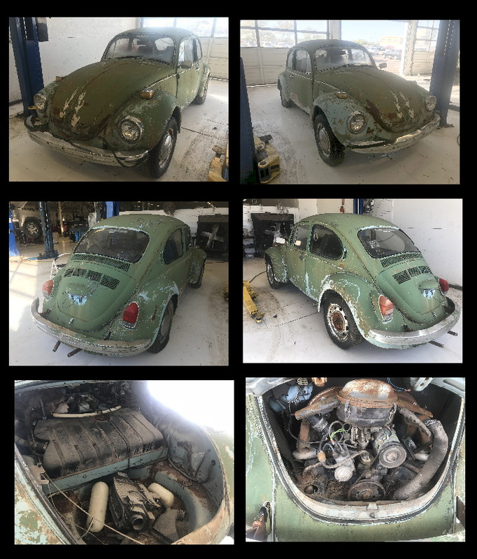

Started looking for a bug and a buddy found this one locally online, and it has the bones of exactly what I've envisioned except it doesn't have an engine, and he wanted more than I was willing to pay.
So I found & bought this one, a 1972 Super Beetle that needs lots of love ... it has the basic engine I want, a 1600 dual port, but had been sitting in a field for at least the last 2 years.

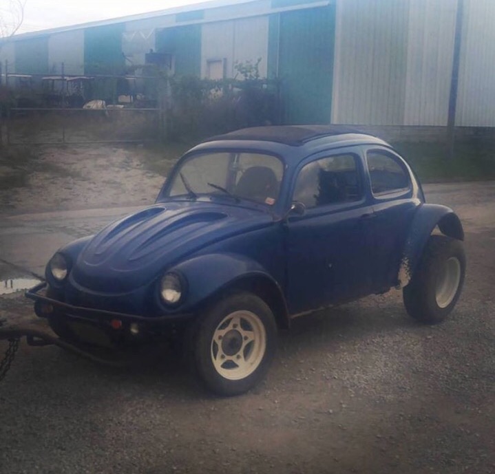

Initially I was thinking this would be a parts car, pull the motor and other 12volt components for the 62 blue ragtop. After tinkering with it for about a month, it's now running, but still needs a lot of love but I started thinking I'd make this my Baja ... I can get a ragtop kit, a 7 piece Baja Kit (4fenders, hood, rear engine trim and front apron), front and rear cage's, 1 piece door glasses ... basically every thing I'd need to make it sorta like my vision for around $2500, and a LOT of work ... Except for its a "Super" which has struts in the front instead of the torsion front end like a standard bug ... which is much more durable for Baja-ing
As you may have surmised ... I'm back on track. And the guy with the '62 Blue called me; his "buyer" backed out ... we came to an understanding ... now I have 2 bugs ... the Baja will need paint, something nice with maybe ghost flames?
For the '72, I'm thinking keep the original "patina" and clear-coat it but it'll still need a ragtop and one-piece Windows ... maybe a 4" chop? And of course repair the huge holes in the floor pan that used to be steel but was reclaimed by salt, rust and life in the mid-west ... I'm bot sure where the 62 came from but it's had much better care as evidenced by a solid floor pan.

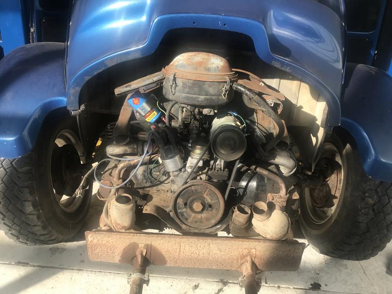

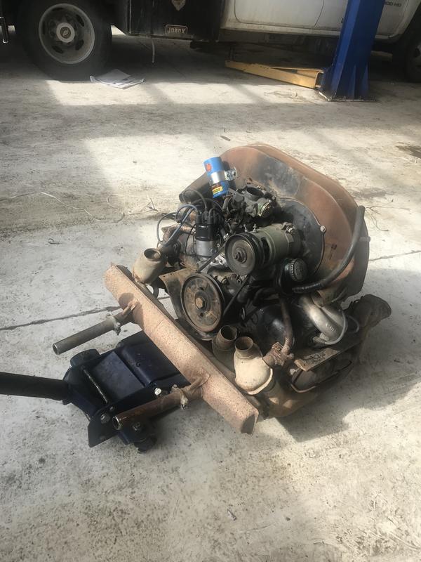

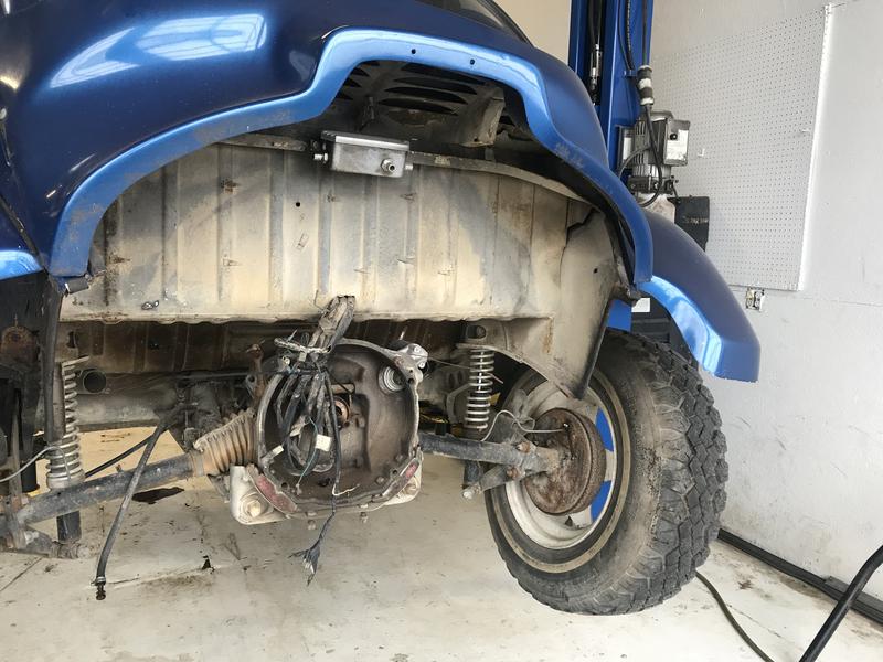

Today I put the EMPI distributor with centrifical advance and electronic ignition in the 1972 dual port 1600 and made sure it was working correctly.
Then pulled the engine ... While I had it out I rotated the generator clockwise 90 and noticed the ground strap screw had been pinching the acceleration pump ... Correcting that made it run much much stronger!
And then put it in my '62 Baja Ragtop
