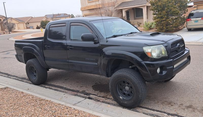

Grandson's Tacoma, we put on a led light bar and a 3" lift kit.
Ŵe also replaced the left front inner axle bearing.
The oem is a needle bearing and if it fails it will kill the front differential, so we replaced the bearing with an aftermarket solid bronze bushing.
The lift came with new front coil overs with extended upper control arms, and blocks with shocks for the rear.

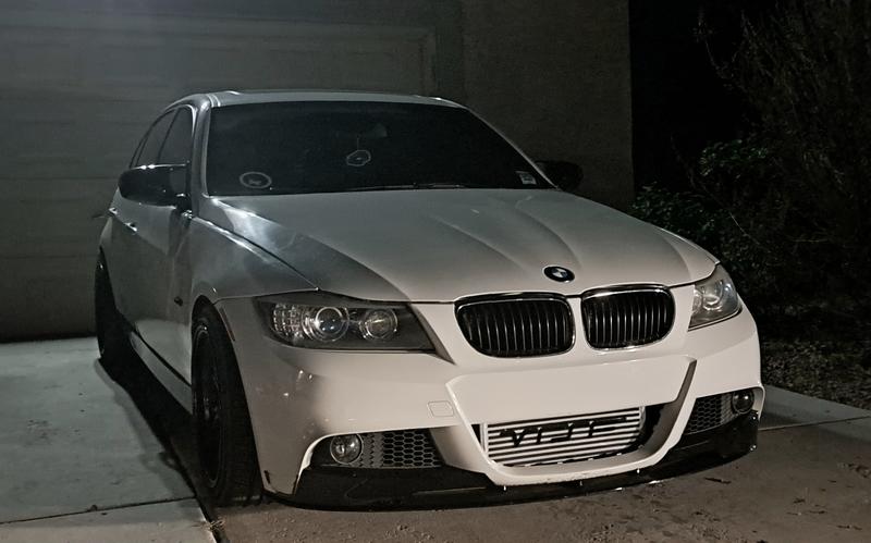

My youngest driving grandson (17) 335i.
He bought this last fall with his own money saved from working.
Originally planned for some mods during Christmas break, but we had a delay with the new turbochargers.
We put on new RB turbos, inlets, outlets, huge intercooler, coils, plugs, charge pipe with a blow off valve, new valve cover, and catless downpipes with new exhaust.
My grandson figured seeing how the sub frame was out we should do the oil pan gasket and rod bearing.
The car is a 2010 BMW 335i with N54, M sport and ppk options, automatic 6 speed.
Getting a tune sent in the near future.

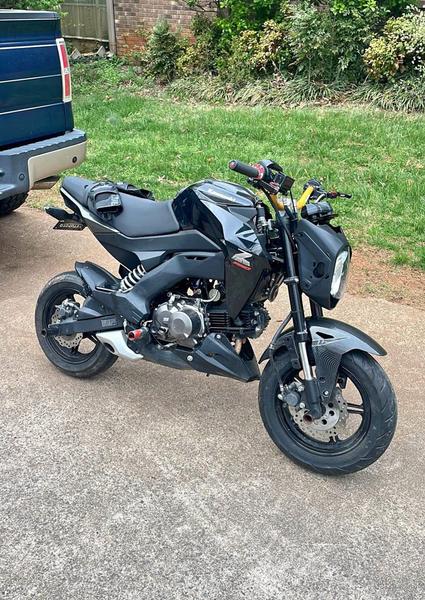

I’ll be replacing some plastics, turn signals and getting it road worthy (and legal). Mechanically it’s sound but cosmetically it’s still got a little ways to go.
I wasn’t planning on getting one of these, I really wanted a Honda Monkey but one came available in my neighborhood for a damn good price.
Coming from riding a BMW R9T & Buell X1 Lightning this little thing is soooooooooo different and WAY more fun than you would think.
