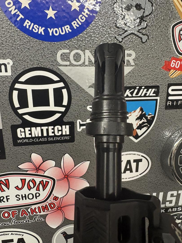

Well, $210 later including muzzle device, hub adapter, rocksett, wheelers upper receiver rod, shims, and an SAE crows foot set I now have my flash hider installed.
I timed it with one prong straight down as suggested earlier though it’s leaned at an angle on the safe so in the picture does not look like it.
Sure beats the need for these huge YHM flash suppressors. The hub adapter also cut about 1 inch off the length of the can. This one is pinned and welded on a Wilson Combat gun. So eventually when I get a new can the YHM will just be dedicated to this rifle and a .308 bolt gun.
$150 of that cost will benefit me in the future for 2 more AR builds I currently have staged and any other muzzle device swap I might deem necessary.
Now just waiting 24 hours for the Rocksett to cure then I’ll fit the suppressor and check alignment.

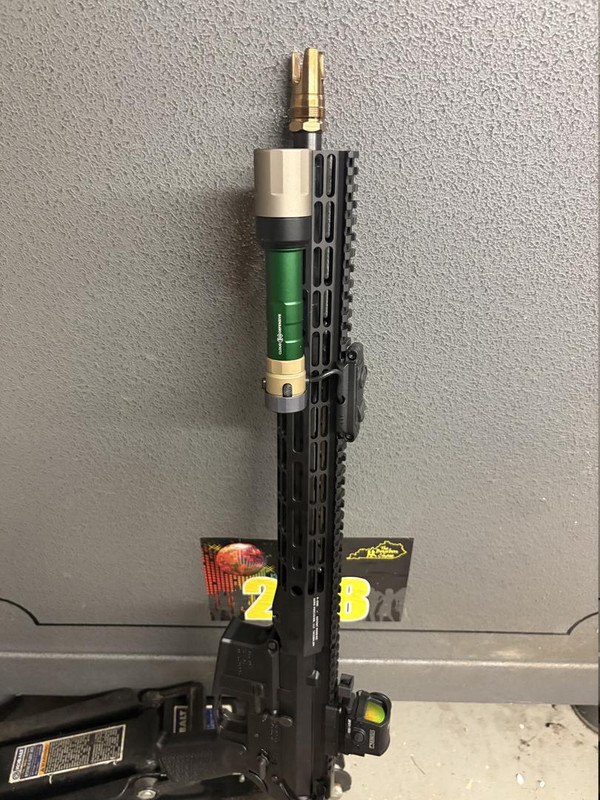

Now you can start saving up for a flashlight that is all one color! Big Grin

Pretty sure I saved like $200 by getting the old surprise mix and match they call the moonshine.
However, I do need to get an all black light since this will be put to duty use once I finish it up.
