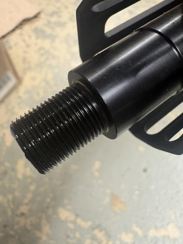

I got me one of those Rearden FHD flash hiders because I converted my YHM Resonator K to plan B.
https://www.reardenmfg.com/product/fhd-flash-hider/
This flash hider does not need to be specifically timed so no shims needed for that aspect. However, the notes say:
Note: your barrel may require a shim if the manufacturer did not put a thread relief on it.
I am not sure what a thread relief means. I presume it means there is just a smidge of non threads prior to where the full contoured portion of the barrel starts.
This is going on an Aero precision factory gun and this is what my muzzle looks like.
I don’t believe I need a shim from looking at the threads on the device and the threads on the muzzle. There appears to be a non threaded shelf on the device that mates with that shelf on the barrel after the threads.
Also half the world says use some sort of rockset or thread locker and the other half of the world says not to.
What should one do?

A couple of my own thoughts.
I had a similar TBAC muzzle device loosen in use, and with which I had used only a little blue Loctite to secure it. After that experience I used the red stuff and more of it when reattaching the device. That was recommended by the TBAC rep when I contacted them for advice.
If the device were mine and there was any chance I’d ever want to fire the gun from the prone without a suppressor attached, I’d want the device to be timed with one of the “prongs” (or whatever they are) at the bottom of the orientation, rather than one of the slots. That would minimize the downward blast that could blow up dirt/debris. I once used a TBAC flash hider on one of my rifles. Its design made it impossible to prevent some downward muzzle blast, and I quickly changed it to a muzzle brake with a closed bottom.
Trigger Warning for anyone who is offended by posts that use information from AI sources, because I got this from Gemini AI:
“In machining and firearms manufacturing, thread relief (also called a thread undercut) refers to a small, unthreaded groove cut into the barrel directly behind the threads, right where they meet the shoulder of the barrel.
“When a machinist cuts threads into a barrel, the cutting tool cannot stop instantly at a perfect ninety-degree angle against the shoulder. Without a relief groove, the last thread or two would taper off and be incomplete.”
I don’t see what appears to be the groove in your photo above.

Sigfreund, it hard to tell in the picture but that last portion that looks like threading just before the shoulder is not threading.
It’s hard to tell in the picture but it goes fully in a concentric circle prior to the should. Not a threaded twist, so it does fit the AI description of a thread relief.
Also, just by hand threading it once I torque it down one of the prongs will be straight down.
Got some Rocksett on the way.

The image on the left is undercut, "relived", on the right is not.
Looking at your picture, I can't tell if your barrel is relived or not.

It is similar to the one on the right the ledge/collar prior to the shoulder is the same height as the threads.
So I guess I’ll toss a shim on there.

Thread relief allows female threaded parts to be able to thread all the way onto a male threaded part without binding up at the end. If cut first, it also makes adding threads much simpler and cleaner. Technically, thread relief should be of a smaller outer diameter than the threads, so there is a difference between thread relief and a portion of just unthreaded material that is the same diameter as the threads.
Here's a good comparison to go with D_Steve's drawing. I would say yours does not have it.

Thanks much, that is exactly what is needed. Mine is nearly identical to the top picture above so shim it is!
I have some that came with my YHM muzzle devices so I’ll toss one of those on when my Rocksett arrives today.
