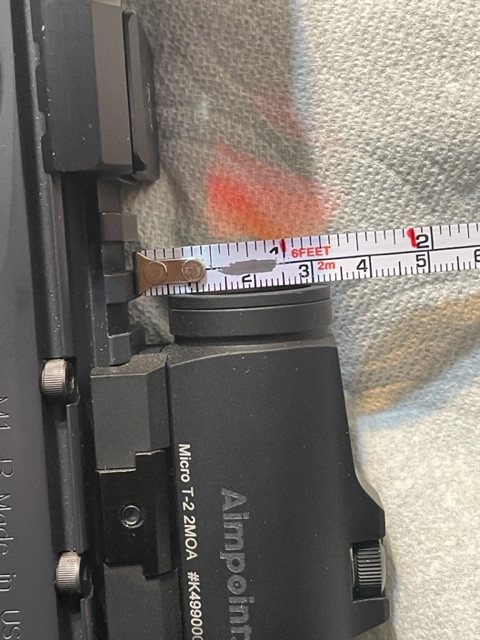

I went with a Micro T2 with standard mount on my AK with Ultimak.
I'm not sure if it would take the heat like the T2 can, but I would also look at the Aimpoint ACRO P2 as it might be lower, but can also add risers to adjust the height.
Just took a pic, hope it helps a little.
