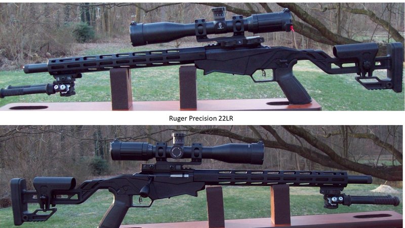

Anyway, currently I'm using a Ruger Precision Rimfire, with a 10x42 SWFA Super Sniper, an Atlas bipod, and a 2 lb. trigger break. Very pleased with this setup but after your review, I see me gifting myself a Tikka T1x Ace Target before too long. Perfect excuse for a new rifle. Smile
Is yours a 16 or 20 inch barrel?

Yes, I could go on and on about the fun—and benefits—of shooting a 22LR rifle (and maybe I will one of these days Wink ).
Mine has a 20 inch barrel.
Long ago I read that the 22 Long Rifle cartridge develops max velocity from about 16 or so inches. As I thought that was desirable I gravitated to that barrel length, for example when I got an aftermarket Lilja barrel for a Ruger 77/22. Much later, though, I ran across an opinion by a top tier 22LR producer that longer barrels are more precise; perhaps they do a better job of stabilizing the bullet. That was the reason I chose the 20" version, and for once it was the model I didn’t want (16") that the vendor didn’t have in stock when I ordered.
And as for the velocity claim, I’ve never made a concerted effort to compare multiple loads in different barrels. I do, however, have some recent velocity data for one load, the SK Standard Plus, fired from three different barrel lengths: 26", 20", and 16". For that load velocities increased from the shortest to the longest barrel, so the 16 inch claim wasn’t true for it. Perhaps that old claim was for supersonic loads or for ammunition of that long ago era.
And yours definitely looks like a nice setup.
