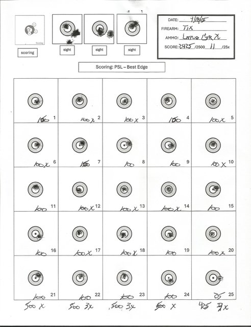

The first (today’s) result. When formally scoring is a scoring plug used or just the calibrated eyeball?
I had planned to fire another string but I was at a public range for the convenience of permanent benches and got chased off when I realized that I was about to be pelted with ejected AR cases from the next guy over.
This should probably be in a different thread because the rifle was a Winchester model 52E using Lapua Center-X, but I thought I should acknowledge your sending me target files here.

Nice shootin. I use plugs on official targets. On homemade one's, I just eyeball it. Not sure you'd get the same performance with a plug on standard card stock. The official targets are printed on a much stouter and coated stock. The fibers don't separate as much as stationery card stock.

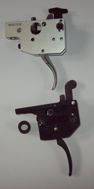

Jard is here but I will post as soon as I can. The Jard is slightly unlike the factory in that the factory has a full housing where the screw attaches it to the action, whereas the Jard is flat with a spacer. I'm waiting for a reply from Jard as to any torque spec to install with the spacer. Afraid if I put it in with The Tikka torque it may crush since the factory trigger was so hard to remove in the first place. Factory on top...

Well...Jard installed. They didn't have a torque spec, so I went with 55 in/lbs. Firm enough to seat but not so much to where you need a breaker bar to get it out like it came from the factory. Raining so will need to wait to shoot but very nice trigger with snap caps. Zero take up, zero over-travel. Clean, crisp break at about an 8oz average and very consistent between 7 & 9. We like it.
BTW...used 60 & 65 in/lbs. on the front and rear action screws respectively. No need for a breaker bar to get those out either.
