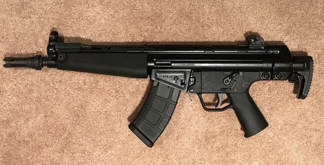

I'm pretty sure the "finish" on mine was just flat black spray paint, maybe even high temp paint like you get at the hardware store to touch up your backyard grill, it wasn't put on very well either as it had both thin spots and runs after the top layer came off, it just looked "well worn" and I didnt worry about it as its a $600 shooter, not a show piece. I did replace the charge handle with one from an HK21, which is longer and easier to operate, the handguard with a correct HK53 and 53 collapsible stock, a QD adapter for my suppressor. Its pictured with the trigger pack it was shipped with, the registered sear is in the newer plastic grip frame.
Thats the bad and the ugly ... the good is that the welds are on mine are on par with genuine HK, maybe better(I've had a couple HK's with very unattractive welds; I attribute the better welds to modern manufacturing processes ... lastly, my HK 4x scope will clamp firmly on to the receiver which is an indication the receiver is "in spec" as many early non-licensed clones, the HK claw style scope mount either wouldn't lock on or fit too loose to be useful.
The sights are straight, and it shoots well. Initially I bought it as a host for my registered HK sear and wasn't planning to SBR it but after a couple outings decided to do the paperwork so I could shoot it as a rifle without the sear. After a few thousand rounds, mostly in full-auto it still runs well and accurate for what it is.
