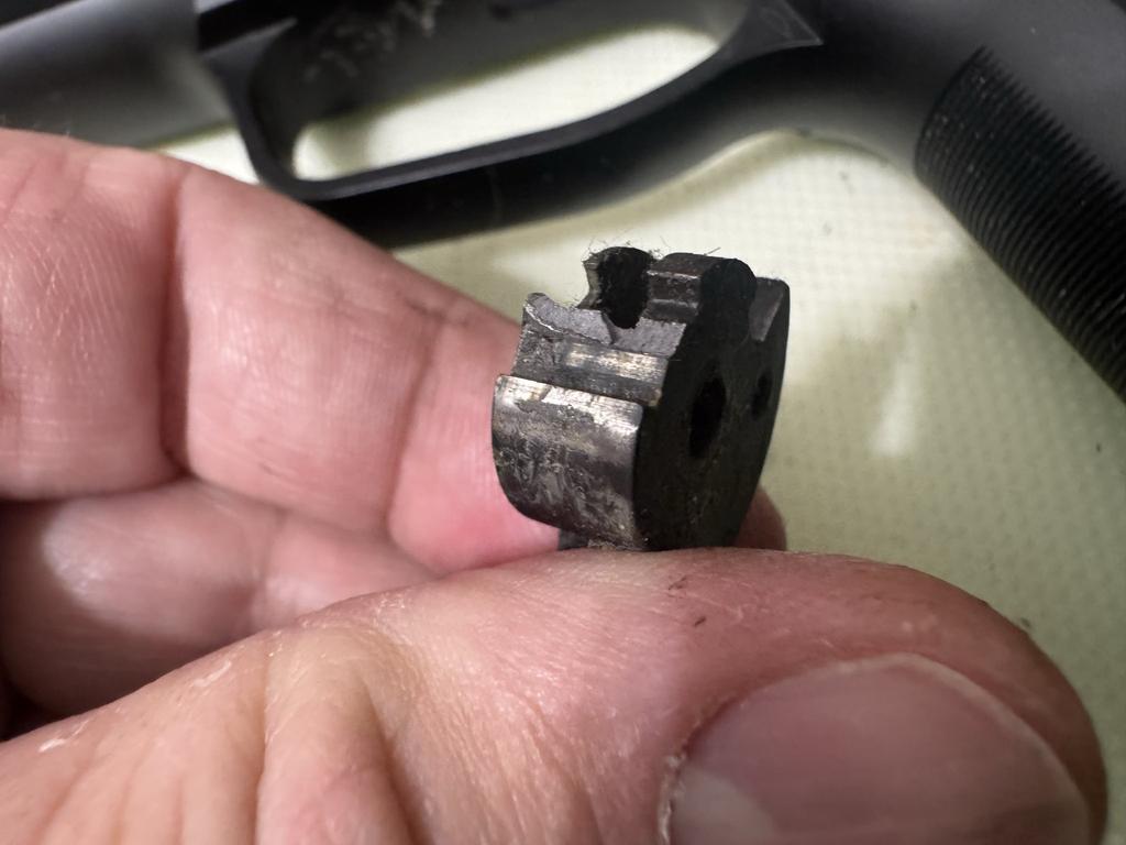

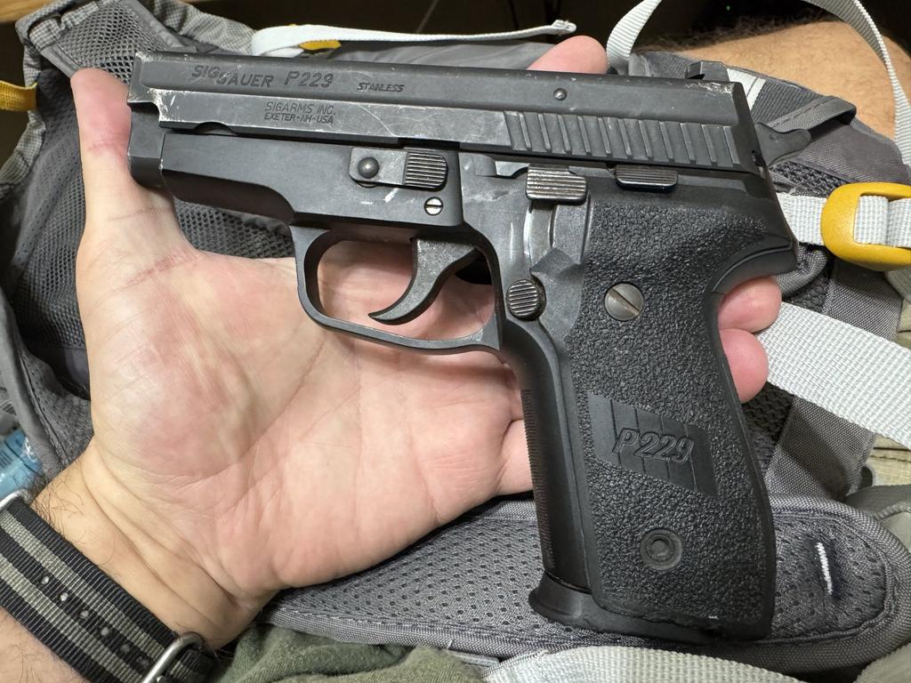

It was so cheap I couldn't say no. Something was clearly wrong with it and having done enough "parts bag" reassemblies on classic P series guns, I felt confident I could fix it. Gun would work correctly in DA mode, but SA either wouldn't catch, or would catch and hold, but throw the decocker all the way down and then randomly drop.
I just pulled it down to the frame, and sure enough, there's your problem right there!
So now I just need to source a cheap replacement and I'm off and running on another 1997 era P229. I think I also still have a set of original factory grips I pulled off one of mine when I bought a set of G10's about a decade or so ago. Need a grip screw also. Not sure what the hell I'm gonna do with a .357 SIG, and I sure don't wanna feed it, but again, it was so cheap I couldn't say no to it. That thread about the Revenant frames has me looking and thinking silly thoughts. I have the ultrasonic heating up and then it's all getting the spa treatment. Looks like an LEO trade-in that was properly greased with TW25B before making it out onto the hillbilly market. I'd bet it hasn't been cleaned in near a decade, based on the crud and rust.

Also looks like a failed mim part, dang.

I'm not going to take after pics until I get it all back together, but everything except the slide and frame came out looking brand new. The most egregious thing on the frame is the docking lever wear, but otherwise, looks great. The Nitron on the slide is fairly worn through in a lot of spots and the finish looks uneven. I'm considering using this as an excuse to go ahead and pick up a cheapo blasting cabinet and do the old classic mod of glass bead blasting the slide on this one. The ones I remember seeing from the early 2010's guys here did looked pretty slick.
Originally posted by -drew5337-:
I had a similar vintage 229 40 that I bought an extra barrel for. Remember when you could get any classic P series from cdnn for less than $500? Better times gents..
I do. Pricing out parts including barrels over the last day or so has been rather surprising.
You know, I've been thinking the exact same thing. It has that powdered metal look to it. I feel like I've read here that the MIM parts from the late 90's and early 2000's were fine, but that things have actually improved. No telling, but it still doesn't give me the warm fuzzies overall.
