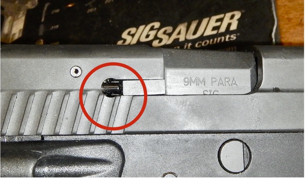

I just took the grips off one and then the slide off and looked as close as I could and no pin is even close to that size... but then I read KRK's post and that is the closest I can see....
You can see the pin behind the extractor:
