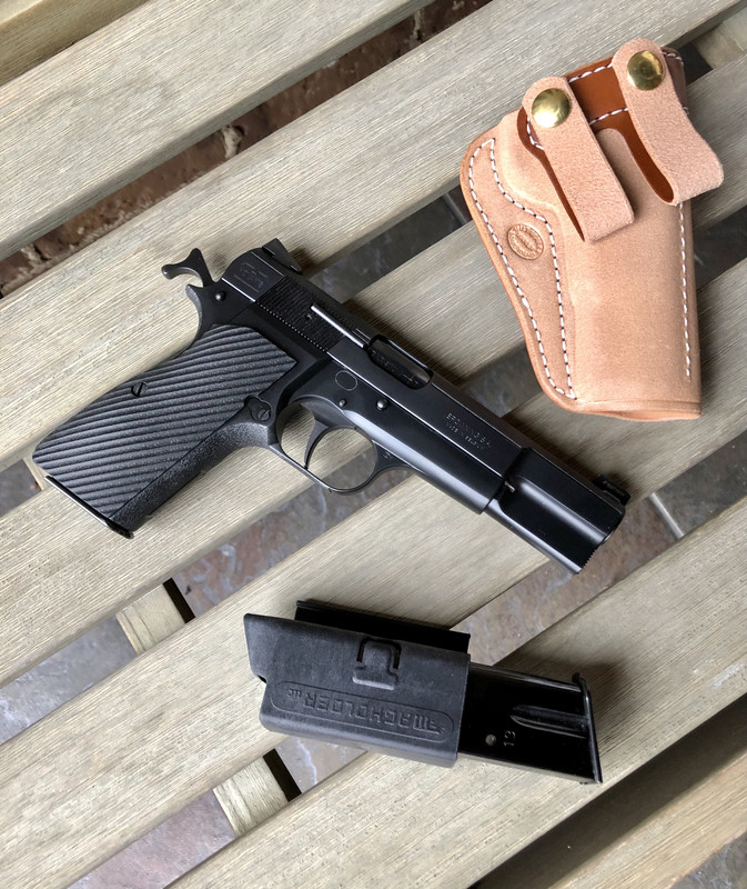

I’m the second owner of a Novak’s BHP with their “Night Ops” package. The original owner also had them install a Garthwaite trigger. Unfortunately, I don’t have the original paperwork and I’m not sure of the trigger weight. This post has me curious to have that officially measured.
That said, the gun had the magazine disconnect removed and definitely has what I’m labeling as the “best” trigger compared to previous BHPs that I’ve owned (none of which were custom / semi-custom, and only one of which also were sans the magazine disconnect). I’ve still had a bit of a learning curve after shooting assorted 1911s primarily for some years.
Ocular confection:
BHP with Milt Sparks Summer Special IWB holster and Magholder horizontal magazine carrier.
