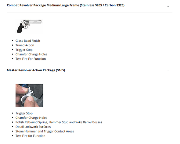

I sent them both to S&W for their Master Revolver Action Package, which cleaned up the trigger.
If that is something that may interest you.
Also had the trigger and hammer replaced with hard chrome on the one I kept with the Culina grips.
PERFORMANCE CENTER® PRECISION GUNSMITHING
