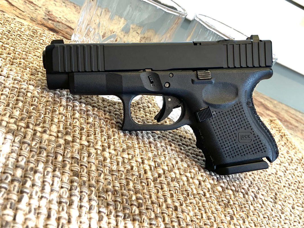

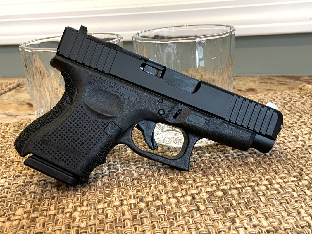

Got sick of waiting for Glock to come out with a factory “26L”, so I put one together myself, and I’m very happy with the results.
I stumbled on Hooper Gun Works, and typed in their search bar “26L” and they had complete slide asmys available. It originally had a bare stainless barrel, but during the checkout process in the notes area I asked if a black barrel could be substituted.
After fast shipping it showed up, and the product is well made.
It is listed for a Gen ¾ model platform. So I used a donor G27 Gen4 that I’ve carried for years. I swapped out the ejector and housing for an appropriate 9mm Gen4 version and put the pistol together. I had an extra set of Ameriglo Protector series night sights to replace the plastic sights on the HGW slide.
The slide is stainless steel, and has an RMR cut if you wanted to add a Tumor.
Yesterday I had some time so I ran over to an indoor range around the corner and put 100 rounds of 115 & 124 RN through it, no issues. I brought a few different JHP’s and defensive rounds I had and fed everything effortlessly.
The gun shoots softer than a G26, and the 15yd group was 1 ragged hole.
Very happy with this so far. I’ll shoot a Club Match or two with it once the weather gets a little warmer to get some more rounds through it but looks like a winner so far!

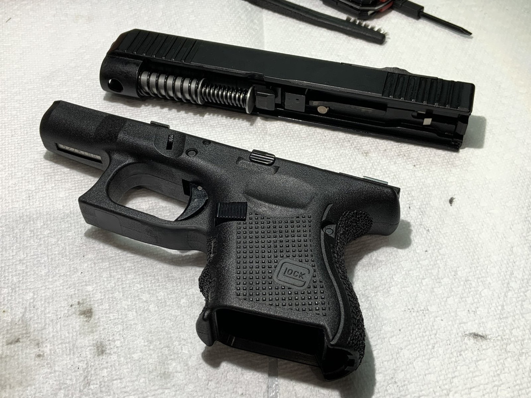

Very nice. I had a Gen3 G26 for years, and really did like that gun. I never looked into doing this, but am I understanding correctly that a factory G19 slide can't just be dropped onto a G26?
From the “test” I did a few years ago I would say no.
Now I forget if I compared Gen3 guns or Gen4 guns, it was probably Gen4, and the main issue was a mismatch of the slide rails distance between them compared to the slide rail cuts on the slide.
The slide rail cuts were not continuous, and had a relief cut which gave no support for at least one side forward slide rail on the G26 grip frame I was using.
I did get the adapter to cover the recoil spring dust cover (Lone Wolf I think). But that was just cosmetic and didn’t resolve the rail support issue.
Now I’m sure back then I was comparing factory Glock parts. Who knows if an aftermarket brand slide had those same relief cuts along the slide rails? If not then it would probably work no problem.
On this HGW “26L” slide, the slide rails are continuous and the dust cover is extended to match the 26 frame profile.
