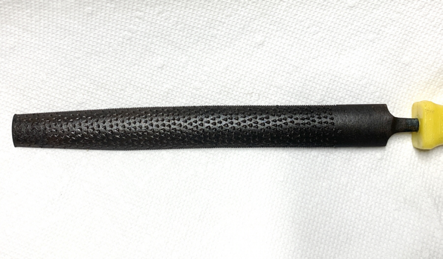

Note, the following image is a rasp that spent 2 years in damp sawdust. When I found it the rasp looked like a rusty corn cob. The rasp now looks like new and is razor sharp. All it was two 45 minute boils, 2o minutes of carding, and a bit of WD-40.
