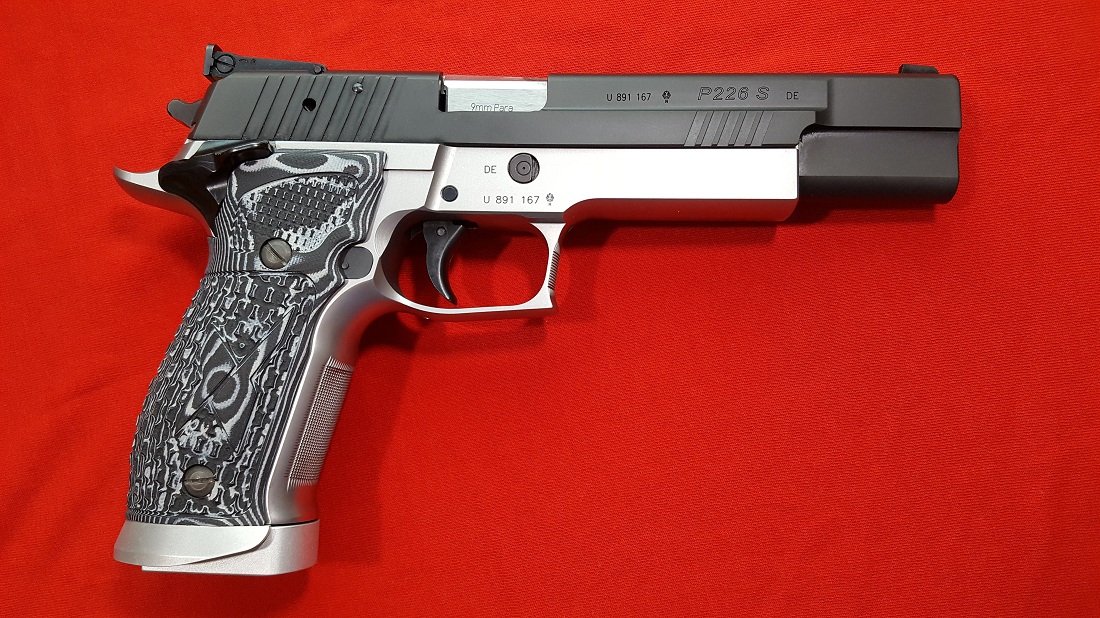

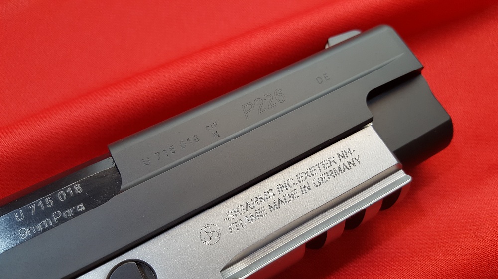

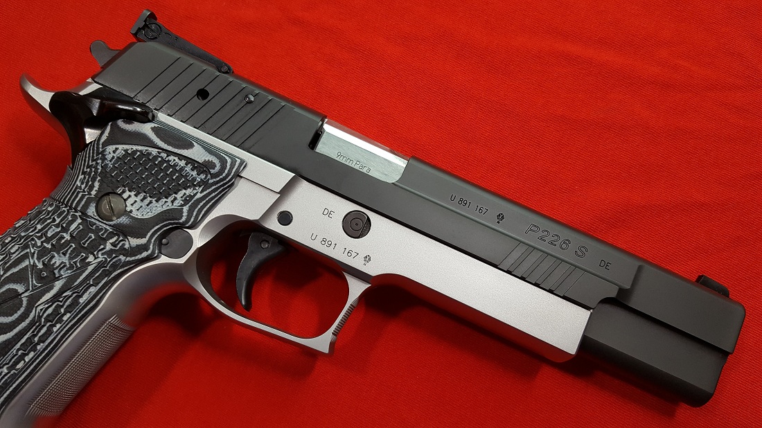

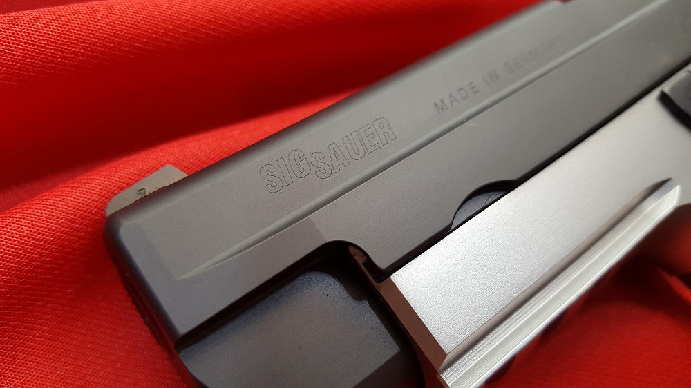

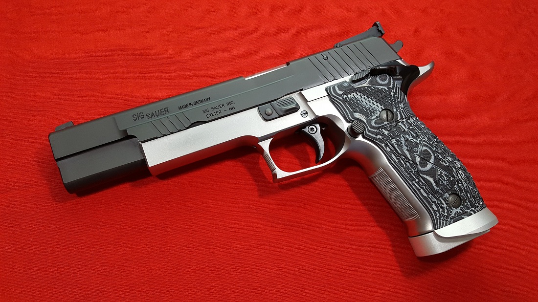

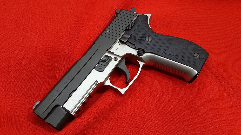

These slides was original natural stainless that I had SIG put their DLC Nitron on.
P226 SL SO
P226 X6 L1
Posts: 31438 | Location: TEXAS | Registered: September 04, 2008Reply With QuoteReport This Post
