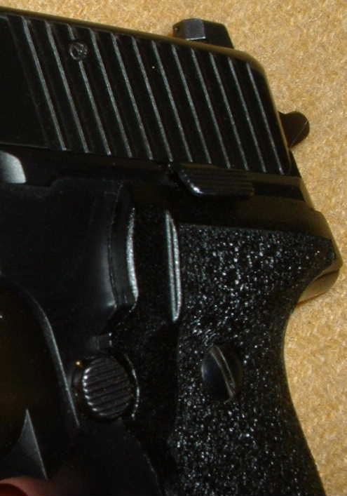

Did your panel look like this?
Nope, not those. I no longer own the gun, but did keep pics of the grips, and will try to find them and post here. I was told on the forum they were very unusual and someone tried to buy them from me. IIRC they were identical to DA/SA grips in every way except no cutout on inside of left panel for decocker.

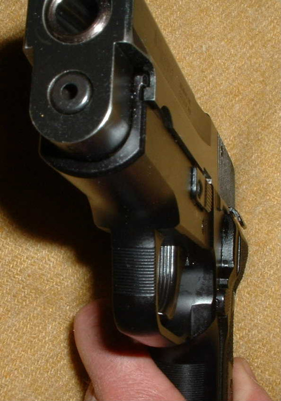

As you can see, the upper left of left grip panel is not cutout on INSIDE for decocking lever. The panel just fits flush against the frame. This is what I had a difficult time convincing folks of before when we discussed this DAO P228. The cutout does still apear on the outside, which is what was throwing people off.
Posts: 2058 | Location: Central NC | Registered: May 18, 2005Reply With QuoteReport This Post
As you can see ....
Thanks for the pictures. I meant to respond to your post and pictures earlier, but got distracted.
Your grip plates are similar to the DAO plates I have, but obviously not the same. That's interesting because it only adds to the mystery of why they were made to superficially resemble standard plates for use with the decocker, but don't permit that.
I agree. They could have just used the standard DA/SA grips. What they actually did seems to have been a half way measure.
