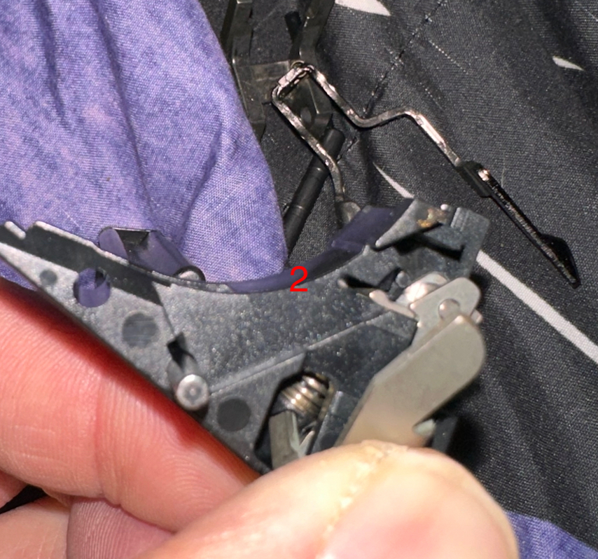

Installed a GPT in a 17.5 recently. Left the dot connector in. Very smooth take up, break and return. The trigger shoe sucks however. Took it off and installed an Overwatch Precision Poly Flat trigger.
That called for about an hour of On The Job Training on getting the trigger return spring seated back on the bar. Expect the next time to go much faster.
If after a few hundred rounds the feel remains the same or close I'm going to stick with the dot connector. If not a 5.5 then a + if needed.
I bought this pick set a while back:
https://www.amazon.com/gp/prod..._image?ie=UTF8&psc=1
Initially, I tried the 90 degree pick to re-seat the spring but I have found that the straight pick works much better. These picks are about 7 inches long and a smaller version would be better for this purpose because I'm holding the pick only about an inch or so above the point when seating the spring.
Whichever tool you use, it needs to have a fine point on it so that you can put the point of the tool in the cup which captures the ledge of the trigger bar.
I've done this enough times that I've gotten good at it, but not infrequently, the spring assembly does not want to move at all when you try to push it backwards. Apparently it's getting hung in some way but I can't determine how. Just make sure that the trigger bar ledge is above the spring when you stick the ledge in the hole and that if you encounter any resistance, don't force it; just start over.

Excellent
One thing, though- it appears that in order to use this technique, the spring cup is being twisted a bit by the trigger bar ledge. I've never bother to check it, but is the other end of that part secured? It seems like the spring cup is always correctly oriented, so if it's secured at the other end, are you twisting this part each time you use this technique?
I guess I could pull out one of my GPTs and check it myself. Is the spring cup/retainer/guide/whatever a plastic part? It appears to be so, and if so, I would be concerned about breaking it.
It's not an obtainable part (at least for now) without buying an entire GPT, so if it broke, it might be costly.

(quote)
Is the spring
/(quote)
Yes,
Pic is of the front of a gen 5 control showing the trigger spring attachment point. The only thing in common with the GPT is this attachment point method. This attachment point on the GPT is in the rear underneath the sear.
And yes I did manage to turn that 90 degrees and it came out, Went back in with some words and tweezers. I finally used a 5/64th roll pin punch to compress spring and install on bar.
Well it didn't take a complete hour, but it sure felt like forever having that "what did i do now moments"
All is well now.
Thanks for posting the pics and links.
And yes I did manage to turn that 90 degrees and it came out, Went back in with some words and tweezers. I finally used a 5/64th roll pin bunch to compress spring and install on bar.
That is a useful bit of information.

I thought about any damage as I was doing it but I figured I’m not doing it every day. I stuck it in my gen5 19 and just put 100 rds through it with no issue.
It’s hooked on the top end. The first time I did the connector change it came off the trigger bar so I kept swinging it up and down until I got it hooked. I really need to buy a set of picks.
