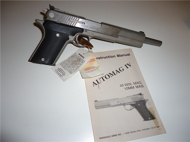

The 10MM Magnum cartridge was introduced in 1992 along with the Auto Mag IV pistol
The Auto Mag IV pistol held 8 rounds of ammunition in the magazine with an additional round of the chamber. The barrel length of the Auto Mag IV was 6" or 8 3/8"
The Auto Mag IV (also Factory availble in 45 Winchester Magnum) never really took off. Conversion barrels were made available in 44 AMP and 357 AMP chamberings giving the pistol some additional versatility
As already mentioned by cee_Kamp the 10MM Magnum cartridge is a stretched version of the 10MM Auto cartridge. The intention of the cartridge was to bring 41 Magnum performance to an Auto Loader, in this it succeeded very very well
