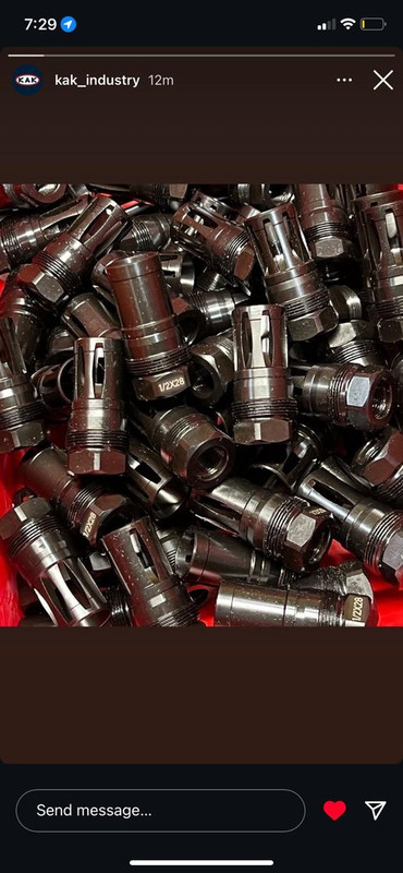

This really isn't a contribution to the above discussion but just an observation. But at the moment is way harder to get certain mounts and muzzle devices than actual suppressors. Rearden is always sold out. KAK is sold out when I looked. I'm months into waiting on KVP for something. I'm several months into waiting on some specific HUB adapters.
So suggestion, once you pick your suppressor and mount strategy go looking. You'll have the suppressor long before you have the mounts IMO.

That's actually a great contribution to this discussion, because mounts are critical to suppressors.

Don't just look; budget as well. Mounts and mount interfaces can be very expensive. I have been needing to get a 1/2x28 OSS flash hider for about a year. I haven't done it based almost solely on the price. Surefire devices are the same way.
